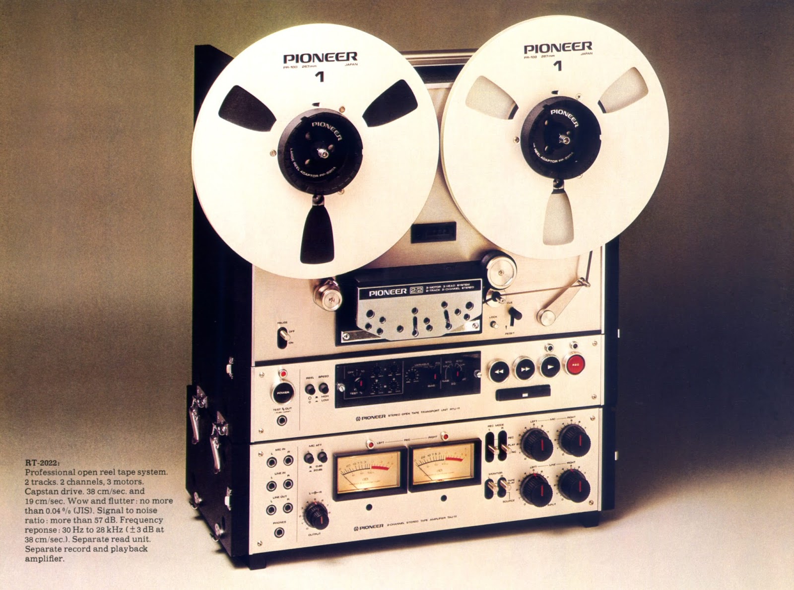

    Silver-faced? Pioneer RT-701, 707, 901 or 909 are pretty nice decks and pretty darned common, too. The somewhat earlier RT-2022 and its kin were pretty nice decks, too, IMO.
    source: http://goldenageofaudio.blogspot.com/2013/08/pioneer-rt-2022-reel-to-reel-deck.html
    FWIW, I'd probably encourage you to look at either slightly newer (late 1970s/early 1980s) consumer R2Rs and/or better "prosumer" decks from (besides AKAI) Pioneer, Technics (Panasonic), TEAC/TASCAM, OTARI, and ReVox. Sony made some prosumer decks as well; some of pretty high repute, but many of the Sonys haven't aged well.
