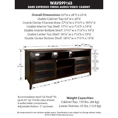

The location I would PREFER to locate the amp is about 18 3/8" wide.
I plan on using the whole middle section of my rack (which looks like this) for the amp, and also plan on putting some spacers below it, and nothing above it. I also have the back of that entire section removed for easier cable mounting so it will not be constricted on the top and bottom, but will be on the sides.

  • Check to see if you have enough working room for an AMP and the cables
    Again it's the width not the height that's the problem with the 2205 parasounds.....
    I have like 24" of height and the Rotel, Parasound 5250 and B&K will all fit in the middle w room to spare as they are 17" amps like the 5 channel Carver I am using now. Those also have similar depth so that's not an issue either.
    Their weight will require me to put some 2x4 under that shelf so it doesn't sag but otherwise they will work fine w more than enough airflow.
    It's only the 2205AT and 2205A that would be an issue and those are not my top picks right now.

    It will be a bit hot but it will have a 18 3/8" wide x 20 deep x 15" tall space to sit in with an open front and back and the bottom of the rack has cooling slots. I am sure it will stay cool enough.
    It also has a 12v trigger I will be using off my Integra so it wont run 24/7.
