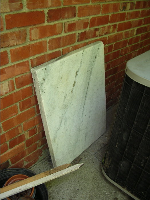

    Would marble be too soft of a stone? Look what I have. I've got a chop saw too. I could cut that sucker in half...it's big and heavy.
  • Hermitism
    Hermitism Posts: 4,341
    edited July 2014
    Never mind. It's not going to work. Let me grab my camera.

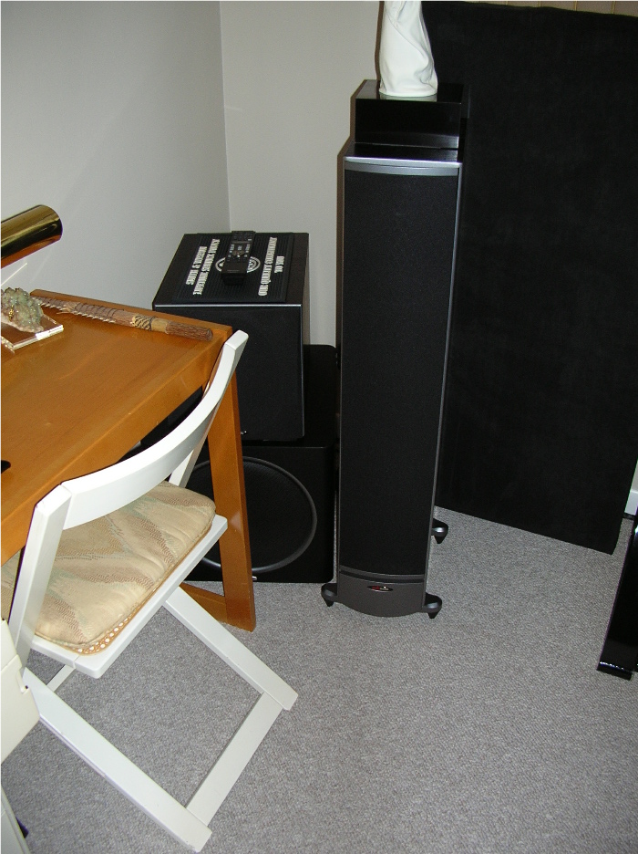

    Remember when you guys helped me with speaker placement? To get the proper width between my front speakers, I had to cram my sub in the corner, which is the only place it will fit. The corner of the sub is closer to the speaker cabinet than the speaker's spikes. And it can't be moved any closer to the side wall.

    What you need are tall, narrow spikes with a sharp tip.
    One of these should do the job.
    http://www.adonacorporation.com/tweaks.html
    Solid Brass Black-chrome Extended Cones - 1 1/4" diameter at the top and 2 1/8" tall. Check that the diameter isn't too big as they would look funny sticking out.
    Black-chrome Slender Cones - 1/2" diameter at the top and 1 3/8" tall.

    The bigger one will fit. The stock ones are approx. 1.5" diameter at the top. When you place an order, do you just tell them what speakers you have and they'll know the thread pattern and screw diameter?
    F1nut Posts: 52,190
    edited July 2014
    They won't know. I'm pretty sure yours are 1/4-20, it's Polk's standard except for the DSW subs, which use 6mm. You can take a stock one off, go to the hardware store grab a 1/4-20 bolt and check that the size/pattern match.
    Edit: checked another thread here, they are 1/4-20.
