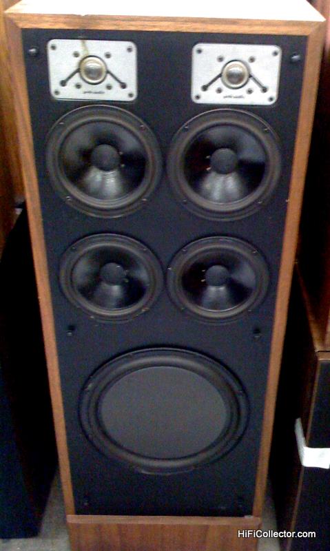

    Polk had a line of loudspeakers with some sort of ambience recovery/"sonic holography" ;-) technology back in the '80s -- the technology, and the family of loudspeakers that bore it, was called SDA (Stereo Dimensional Array).

    They're very popular with the vintage Polk fanboys, and they go for some serious Gelt... but (FWIW) I am not a big fan. They take a basic concept and stretch it too far for my taste.
    Here's a good source of info: http://www.polksda.com
