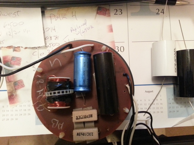

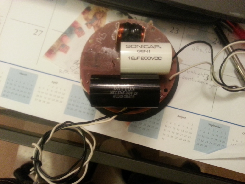

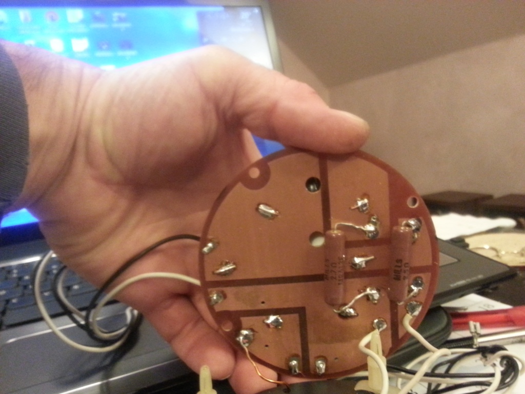

    Picked these up for $50 about 6 months ago. In original boxes and pristine. A little cleaning and a crossover rebuild. I think you will be quite happy with them.

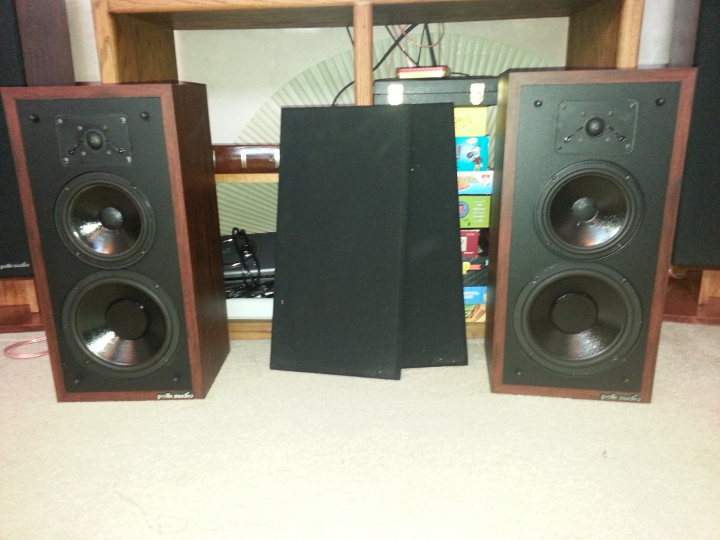

    I picked up the Monitor 5's and they sound wonderful! Best $75.00 ever spent on speakers.
