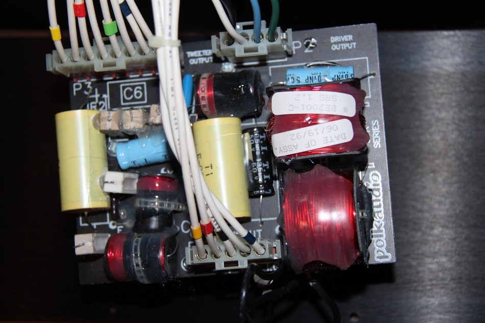

    I appreciate all the help and info! I took the crossover panel out -carefully- and inspected for bad things. Since I had no idea what I was looking for, I found nothing. No mouse **** or chewed wires. I did take pictures of the crossover, the inside of the back panel, and my wire connections. As soon as I figure out how to post a picture I will do so. I'm using a Yamaha receiver for now- RX 797. I was told by a Polkie recently that 95% of amps are now "common ground"- and I thought those odds were good enough. I might be wrong. Once again I am very appreciative for everyone's assistance.

    F1nut Posts: 51,786
    edited June 2014
    Post #14.
    First pic shows that the top left post has been replaced.
    Third pic shows someone was messing around with the posts and the SDA connection.

    Previous owner said he did replace the "top left post" on the right speaker but that it worked perfectly. Am I doing something wrong or inefficient in the external wire hookups? Do the jumpers look OK (if amateurish)?

    did Polk use coloured bands on the wiring coming off the connector on the top left, I'm assuming that leads to the tweeter array ?
    Yes and yes.
