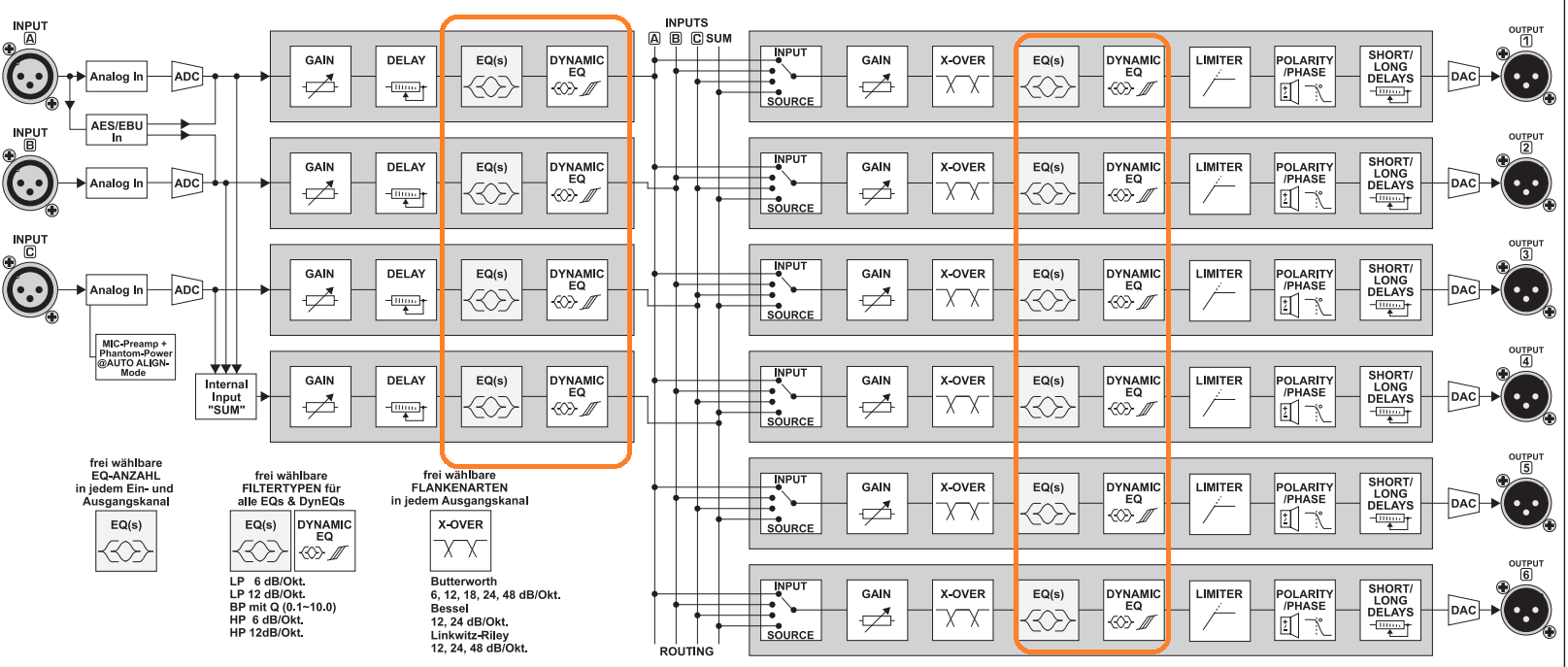

    I don't think you understand what SUM'ing is. You have to measure monophonically to do it correctly. You measure each source speaker, apply EQ, and then SUM the entire setup and apply what ever house curve or BBC dip desired up stream of the individual PEQ applied.
    That is why on the signal routing matrix you see on a speaker management system you can apply EQ at the stereo input and EQ on the channel output.
    You EQ the channel output first and then apply global correction on the stereo input. The individual PEQ's then track to the master input signal.
    Here is a screenshot from a speaker management system showing how this would generally work. This is of course dependent on setup. The other thing to think about: Does the auto correction on an AVR play speakers in tandem or does it do one speaker at a time?
    For some reason, I was thinking a sub setup focused on <80hz. But if you want to apply EQ above 80hz into the upper bass region then doing it monophonically would make sense. However, since bass is not stereophonic below 80hz, the primary concern is the in-room response from both speakers. Thus I was also thinking of an external EQ applied once.
    This begs the question then to the OP, how are you applying PEQ's? It did not sound as though he was using bass management to apply EQ.
