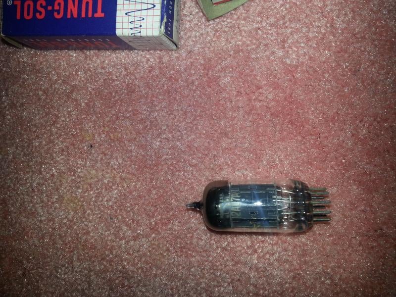

This round I am going to try out some Amperex Holland 6DJ8 that have the cartoon on them (BB) but, I am going to change out the 12au7. In my possession, I have what looks like a westinghouse, carbon 12au7 that I am thinking of trying next. The writing is hard to read but i can make the word westinghouse on it, plates are a weird carbon blackish color ,at the top of the tube reads made in the USA and a few dots above where it reads 12AU7. I took a look on the web and several people were saying this is supposed to be a jem of a tube.

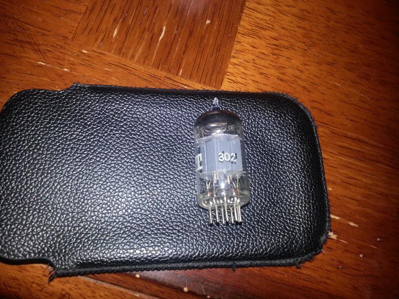

I also have and ITT 12au7. Not sure on the date or anything else outside of a 302 on the body of it.

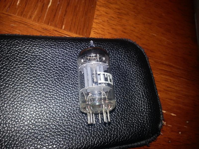

Out of the 12au7's i listed, what do you think would match up well with the Amperex Holland? Or even any of the 6DJ8 that I have listed.

    The ITT tube is rebranded tube and I don't recognize the "302" as an EIA code. The Philips made tubes have an acid etched code toward the bottom that consists of 2 lines of code. Does the ITT have a code like that? If not, it's either American or Japanese. Is the 302 vertical or horizontal?

    Here is the westinghouse. I will say the combo of the westinghouse & the Amperex BB is nice! Way better then I thought! I like the westighouse au7 with the BB better then the Mullard BB combo in the cayin.
    Its hard to read much on it since a lot of the writing has worn off.

    The ITT tube is hard to tell but it appears American made, but it could be Japanese.
    I find the Westinghouse to be an excellent 12AU7 and fairly rare for if it's legit as this seems to be. A bit of a sleeper as the real thing is hard to come by.

    I agree on the westinghouse being a sleeper. I almost passed it over in the box of stuff I picked up. When i took a look at it, the color of the plate and the dots were gray on the other one. The other one kind of looked like a ge coloring. looked different then the other westinghouse that was in the box so I looked it up. I am glad i did!

    Your Westinghouse sounds like the real deal. Yellow print, 337 is the EIA code for Westinghouse tubes, 3 gray dots (a bit different looking than GE), charcoal to charcoal silverish long plates (muddy looking), long arm "D" type getter means it's a true Westinghouse. Not a rebranded tube.
