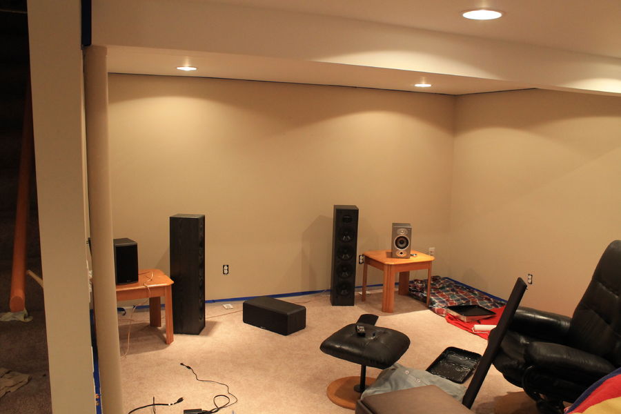

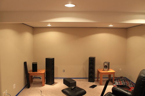

Here is the look of my room in progress:
