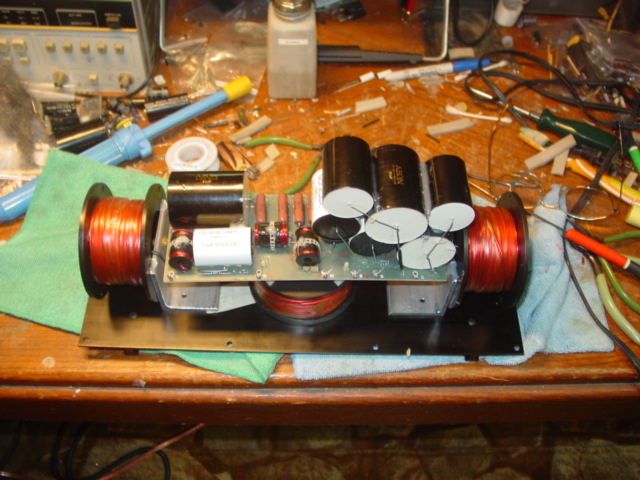

    I just saw a pic of 1 of my x/o's, looks crowded. There's quite a difference between the older and newer boards. Mine(older) is bigger, so more room for those monster caps, which my tech likes. It also has 3 coils, instead of the 1 the 1.2's have. FWI; you guys have one of the finest vintage techs on the planet here. embrown057

    Picture added for entertainment purposes.
