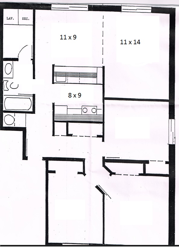

    Hi again!
    I'm trying to find a pair of floorstanding speakers under 2k that are big enough to fill an average to large room (See plan: Speakers would be located at the bottom of the 11'x14' living room... but this area opens to a 9'x11' dinning room area, a 8'x9' kitchen and a small hallway). The fact that there is no walls or doors except near the bathroom or the bedrooms (three smaller rooms at the bottom of the plan), might not help, isn't?
    I mean, I do not know how it will sound, but sure thing, even if the listening area is limited to the 11'x14' "room", sound will go here and there and there is nothing I can do: would a pair of tower speakers be able to pressurise the listening area correctly at a lower to moderate volume level, or is it impossible considering that it will have to fill something like 450 sq ft (if we consider the kitchen area, the dinning room, the living room and the hallway)?
    One thing is sure, small bookshelf probably won't cut it...
