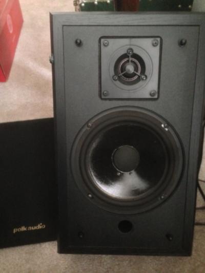

I bought a pair of Monitor 5's brand new around 1984. I've used them to anchor my system throughout these many years, from simple stereo through 2.1 surround sound all the way to my present 5.1 set up which is

I'm seriously considering an upgrade to the mains and the center.
...but...
Every time I shop around for new mains I'm not impressed with upgraded speakers that are reasonably sized and priced. I come home, crank up my monitor 5's and think, "these still sound great and I already have them sitting right here." The only speakers that even tempted me were Martin Logan Motion 12's a few years back, replaced with the Motion 40's and run $1900 a pair. I'm all-right with spending a few thousand on some replacements, but they need to sound seriously better than what I have now.
I'm pretty sure I want to upgrade the center to a CsiA6, but want to sort the whole rig out before I commit.
I mostly use the system for movies, but sometimes crank classic and newer alternative rock.
This seems a good place to get some reasonable advice. I obviously like the vintage Polk "natural sound".
- What price point is reasonable to expect a new speaker to outperform my monitor 5's?
- Would I be better off spending a lot less upgrading the crossover and tweeters of my monitor 5's?
- What other speakers should I listen to as reasonable upgrades?
- Is the CsiA4 or A6 a better center channel to match my monitor 5's if I do decide to keep them?
THANKS!

    Which tweeters do your 5s have? If I'm not mistaken, circa 1984 is when Polk switched from the Peerless (see examples here) to the SL1000. If you have the Peerless I believe the conventional wisdom would be to keep them - plus there's no drop-in upgrade other than a Peerless knockoff one vendor now offers. If you have the SL1000 I believe the CW would be to upgrade posthaste to the drop-in replacement RDO-194-1 for around $100/pair shipped from Polk CS when you tell them you're in Club Polk. (I will keep the Peerless in my 5s and upgrade from SL2000s in my 7s.)
    Would I really notice a significant different between monitor 7's over my monitor 5's in such a small room - or would I need to step up to or something like the SDA's CRS?
    My 5's do not have peerless tweeters, they're the silver domes with the wires going straight out - I've not removed them to check nor modded them so they're most likely SL1000's.
    Just noticed this - if the leads are going straight out and it says Silver Coil Dome I believe that would be the SL2000, also not highly regarded by most here. The RDO-194-1 would be the upgrade path either way.

    mikemokr wrote: »
    Everything I've read here, or elsewhere, supports your statement about that tweeter being a SL2000... BUT, I upgraded my 10B tweeters to the RDOs a few days ago, believing that both tweeters were SL2000s.. They look like every SL2000 I've seen and are both identical. One of the tweeters has a factory label on the back with Nov. 1984 inspection date and is clearly labeled SL1000. The other tweeter also has Nov. 1984 inspection date and is labeled SL2000. Different labels, both with distinct model numbers. Who can explain that? Just labeled wrong at the factory?

    I popped the tweeter out and it is indeed an SL2000. I'm going to start a new thread to work out the details around upgrading the tweeters and especially the crossover.

    Interesting thought there too, I have a pair of Monitor 4's hiding in the living room. I'm going to try them out as an alternative to my CS245i center.
    If you had mentioned THAT at the top of the thread it would have made it much shorter ;-)
    (2) Polk RC80i (Top Middle)
    Polk CS300 center channel
  • Zentish
    Zentish Posts: 127
    edited February 2014
    StantonZ wrote: »
    It's funny - as a computer guy I've always believed that when it comes to electronics, newer is better: newer modern materiel's, electronics, technology, etc.
    So the idea that these little old speakers I spent $80 a piece for in 1991 are superior to newer stuff now that I have a lot bigger budget is sort of a "blind spot" in my thought process.
    The M4's used to be my surrounds, but they didn't fit very well after we turned the home theater room 90 degrees. So i bought some low profile Klipsch's and moved the M4's out into the living room for my zone 2.
    I see there a number of different Monitor 4 speakers. Mine say "Monitor Series" and M4 on the rear. I purchased them in 1991 and the receipt says "Polk M4A". Are they truly M4A's or some other variation?
    THANKS!
