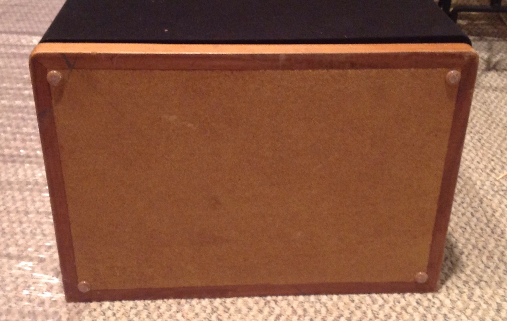

    I'll also be heading down this road shorty, but with veneered 1Cs. There no veneer on the bottom, just MDF. Mine will be on carpet How should they be attached? Will the MDF be strong enough?

    You'll need threaded inserts or T-nuts. There should be veneer on the bottom unless it was removed by someone. Regardless, you would be drilling into the MDF anyway as the veneer is very thin.

    I have the non studio version. Here is a picture of the Bottom.
    You was robbed! :razz:
    Yep, drill into the MDF.
    LOL They took it from a place hardly anybody looks at.....
    IIRC most of the Parts Express spike kits are supplied with the barbed insert nuts.

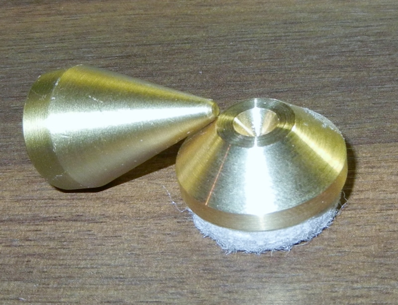

    SCompRacer Posts: 9,407
    edited January 2014
    That's why I mentioned the depth of the point hole in the pad. I posted a pic of the Mye point pad with its deeper point dimple. With a shallow point dimple you risk the spike slipping out as you move the speakers.
    The point pads that came with my NHT subs had a shallow dimple in one side and a deeper dimple in the other, so check both sides when you get them. You can find the adhesive felt pads at hardware and home depot type stores in varying diameters. The felt pads are available in black too.
