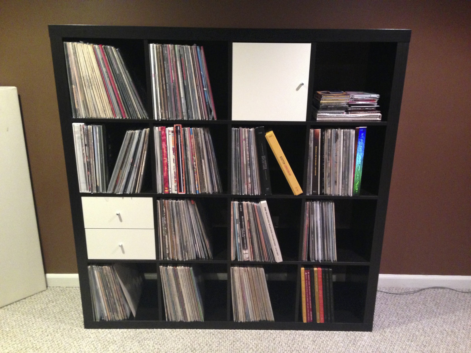

    Here are a few shots of the 4x4 Expedit I just built:
    mhardy6647 Posts: 35,562
    edited February 2014
    looks good!
