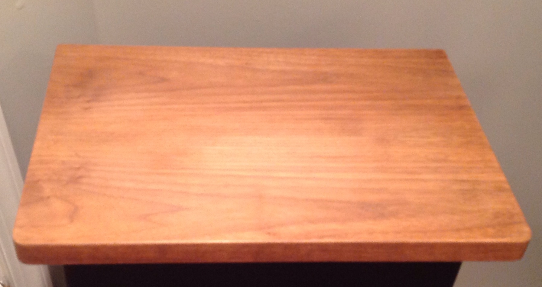

Any suggestions?

    1 doesn't look all that bad but the one w/ the bigger stains might need the full bleach treatment and the steps that follow. Ask Jesse if they are salvagable w/ just a sanding ,if not then it's Oxalic acid to bleach both tops>tack off> sand w/ 150 grit> tack off> check severity of stain,if still exsists repeat.If all good then pick a stain you like apply w/ the grain let dry fully then apply either a poly satin or some people use wax to finish up theirs. As you can clearly see in the 1st pix I have a deep water stain and it was on both tops.If I were to sand that it would have left no wood it was that deep so it was the bleach method for me.Keep in mind in the finished one the poly has not been applied yet.
    If using this oxalic acid do not water it down as the box says .My box said for dimensions of a deck,her you need a thicker tooth paste consistancy and not to leave it on so long as to warp the wood your trying to make beautiful.I got mine at Sipperstein Paints for $4 and ther is plenty in the box.So supplies, Oaxolic Acid, Tack Rags, Sand paper, face masks, vacumm,stain, and finish.Jesse will recommend to take the tops of the cabinets,I couldn't do it not manly enough so I rapped the cabinets w/ a comercial graderol of seran rap and painters tape and no leaks if done right.
    Again confer w/ F-1 Jesse a pro woodworker ,a profectionist and likes to see projects turn out right under his tutilidge

    Just don't get carried away with a sander, the caps are veneer over mdf.

    Those should be veneered. A sure fire way to tell if the end caps are solid wood or veneered is to look at the letf and right sides of the end cap. If you see end grain, it's solid wood. If you see face grain, it's veneer.

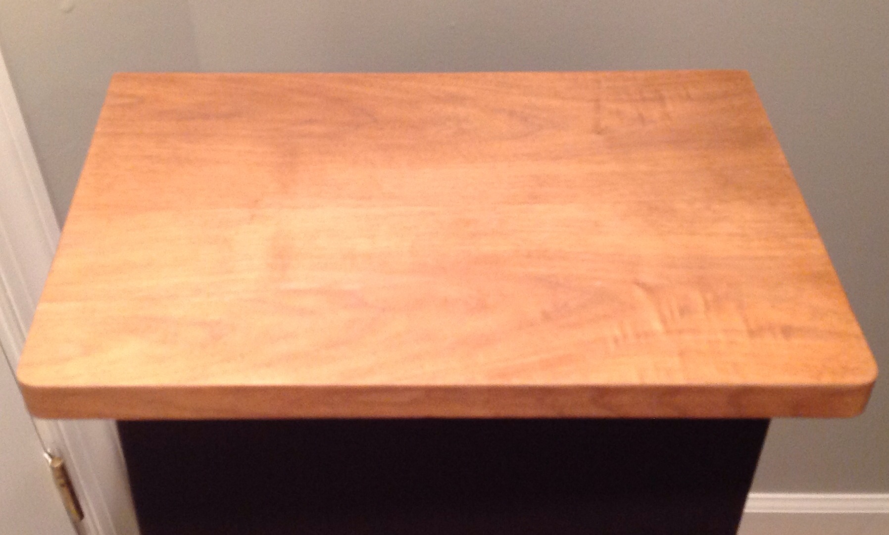

    Ok tops are off and finish is removed. Not sure if I need to bleach.
    Not sure if mark running across the grain are stains or imperfections. What do you think?

    you definitely need a better camera or better focus...:wink:
  • Easy Runnin
    Easy Runnin Posts: 501
    edited January 2014
    Really? They don't look bad on my iPad. I been having a lot of trouble lately posting picture. "File size too large" errors. I took the last 3 at a distanced then cropped them.

    Yeah, out of focus. Anyway, you don't need to bleach.
