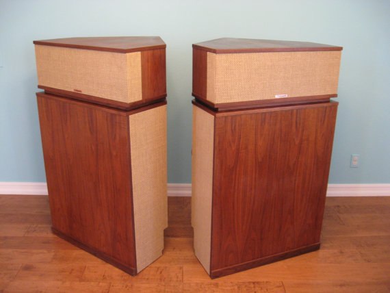

    Actually checked all of my closets this morning and in my wife's clothes closet I found a pair of Klipsch Corner Horns!!!!!
