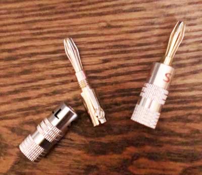

I just got my new RTi A3 speakers, trying to attach some banana plugs and can't do it! They are the: Sewell Direct SW-29751-6 Silverback Banana Plugs, gold-plated and work great to get the wire in. From Amazon, at: http://www.amazon.com/gp/product/B005E1CGZC/ref=oh_details_o06_s00_i00?ie=UTF8&psc=1. (picture below of one put together, the other in the two pieces ready to insert the wire)
Polk Audio tech support says they should "fit" into the binding post, then hold firm by **** the plastic cap back on. Doesn't work, they don't fit INTO anything, just about 1/8" of the tip sits in the binding post, but falls right off, through the plastic cap.
NOTE: The manual says to "gently PRY OUT the binding post" to expose the place for the banana plug. I had tried that, trying to pry under the round gold plate (base of the binding post) but couldn't get it popped out ... was afraid I'd damage something, so called tech support.

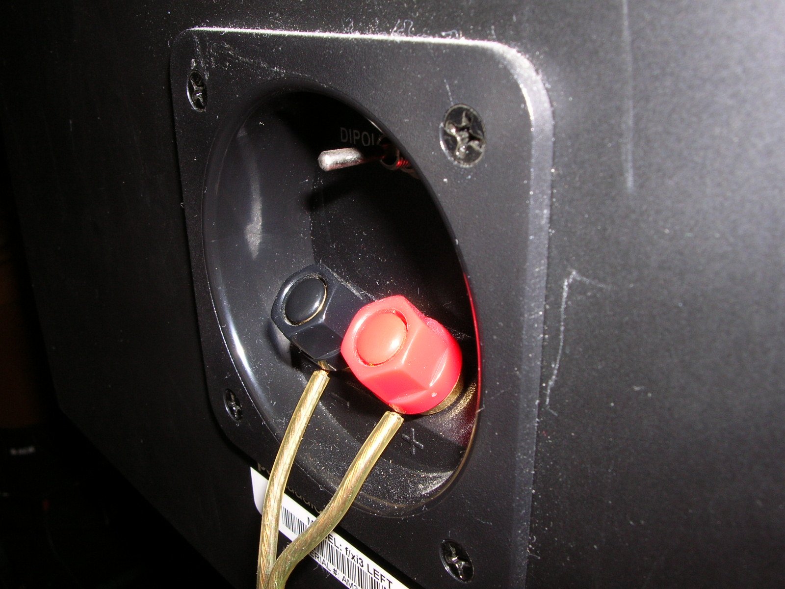

    The part that you pry out is the middle of the plastic cap that you screws onto the binding post.
    F1nut Posts: 51,798
    edited November 2013
    The pop out comment refers to the small red and black plastic plugs in the center of each binding post. Have you removed those?
    Do NOT pry under the round gold plate (base of the binding post).

    Thanks, I looked at those. I have no trouble putting the banana plugs on ... these were really easy. But. they're obviously bigger, would never fit into the binding posts on these speakers.
    So, what type of banana plugs fit the RTi A3 speakers??? A pin type? The ones I have have a tip like a large Phillips screwdriver!

    F1nut Posts: 51,798
    Ok, I see what the problem is. The expandable section of the plug is too close to the tip, which is a piss poor design, IMO. The better designed plugs expand in the middle section. For what they cost you I'd just throw them away.
    These will work, see how they expand in the middle?

    I might be a total idiot but when you unscrew the red and black caps, take out the little plastic plug, the only opening to insert anything is the hole in the metal binding post stem. The banana plug isn't supposed to plug into the plastic cap piece, is it?
    tonyb wrote: »
    Jenny,
    Just to be clear, your trying to put the banana into the center of the post, not the hole in the stem when you unscrew the cap, correct ?
    Ummmm....yeah.

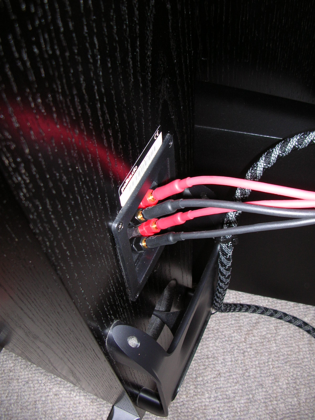

  • Hermitism
    Hermitism Posts: 4,329
    F1nut Posts: 51,798
    Reading that again.....let me clarify. Screw the plastic binding post nuts down tight. At that point all you will see is a hole at the top. That's where the banana plug goes.
    Edit: a picture is worth a thousand words, way to go Hermit.

    There might be plastic caps covering the hole.
  • JennyM
    JennyM Posts: 27
    THAT is exactly what I needed someone to tell me!!! And, Hermit, that picture helped too! I have never seen banana plugs before, actually didn't even know they were expanded. Just looked like there was no way they'd fit into the post on the RTi speakers. And, the manual saying to "pry the binding post out" was pretty misleading! There was nothing to "pry out" ... the little cap in the nut simply fell out.
    I should have looked at my CSi3 first ... it was obvious that the only thing to pry out was the little cap top. Then, knowing (as I do now) to screw the nut down first, it was a breeze to push the banana plug in. I now have the center hooked up with banana plugs, on the receiver too. And, can go forward with the other speakers ... thanks to the help of all of you here!
