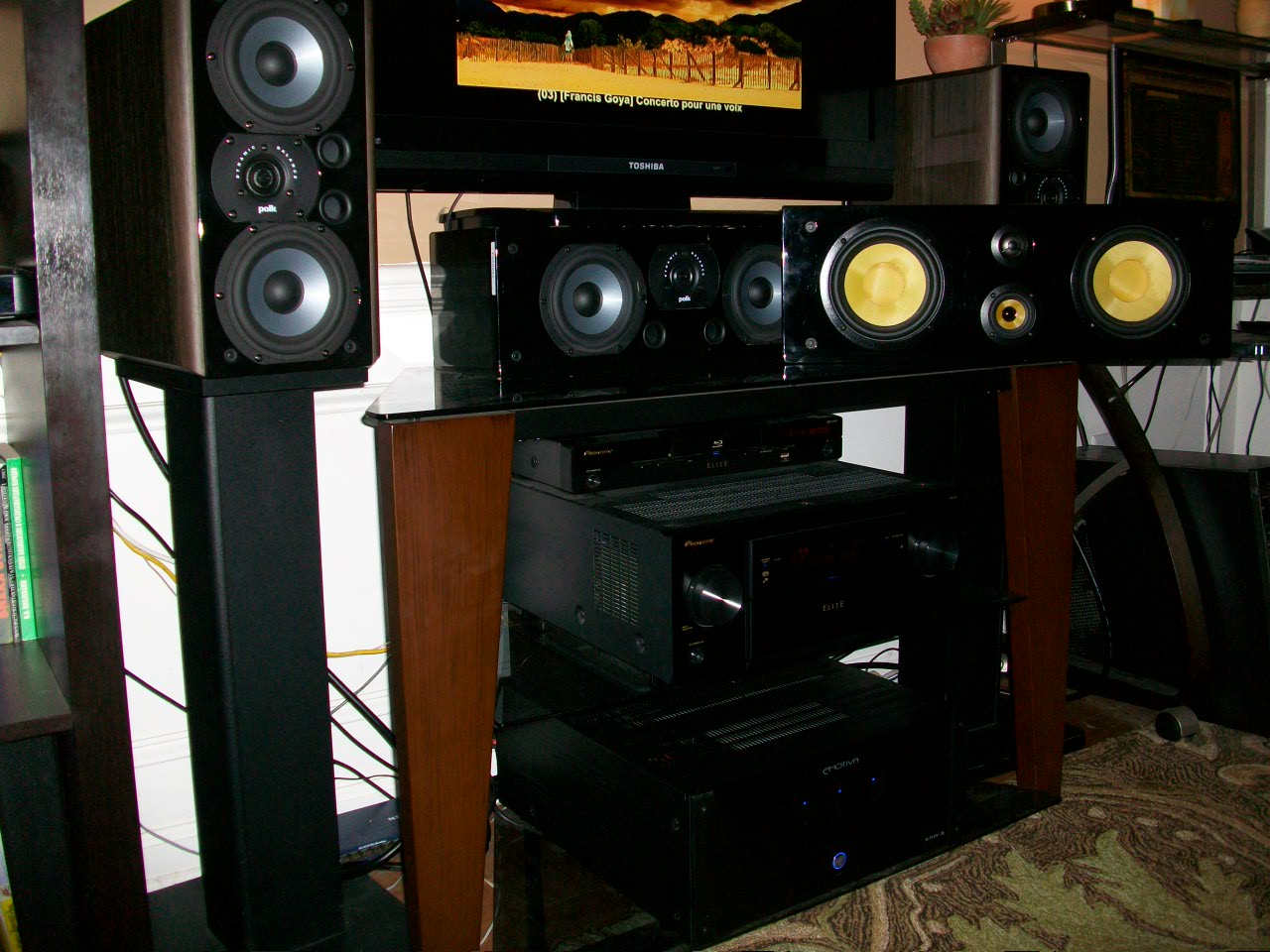

    I found the perpetrator. Here is the mugshot:

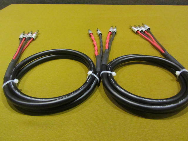

    Like I mentioned before, I got the LSi-C and the new cable on the same day. The Canare always require 1-2 days break in time. I left it playing overnight, but didn't check in the morning if there was an improvement. Now I reconnected the LSi-C after some break in and sound was improved. It matches the LSi-9s now. One problem didnt go away (and I dont think it ever will) - its this boxy, nasal quality to the LSi-C. But if you compare the LSi-C and LSi-9, the enclosure quality is far superior in the LSi-9. Its is simply formidable. 1.5 inch sides, heavy as hell! Lsi-C - not so much. So, what would you expect?
    Comparing the old Bic America and LSi-C after speaker cable break in left me with this impression. Bic America is loud, bright, in-your-face so to speak. I can crank it up to +20 and get tired after 10 minutes (all other channels defeated). LSi-C is different. It is understated now, not mute or even shy. I can crank it up to -7 and listen to it for about 40 minutes before I get the sense of fatigue. But the main difference is in what I hear. The crash of cymbals are suspended longer in the end. The instruments are more vivid, detailed, then dont step on each other.
    Its like having to guests for dinner. One is loud, obnoxious, demands attention, grabs you by the arm, tells you at first entertaining stories until you realize in a few minutes that they are all lies. The other guest is silent until you mention that you have a problem lets say with the the car, or the IRS, or whatever. He says "I can fix that" and he somehow he does. Which guest would I love to have around?
    That is what LSi-C became after cable break in.

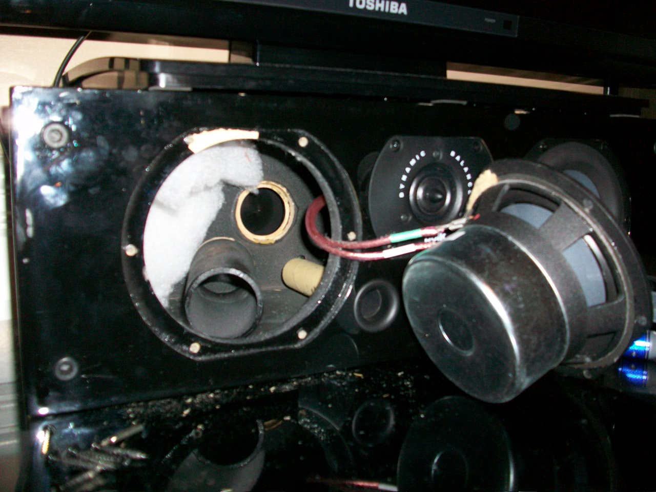

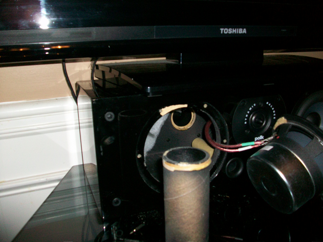

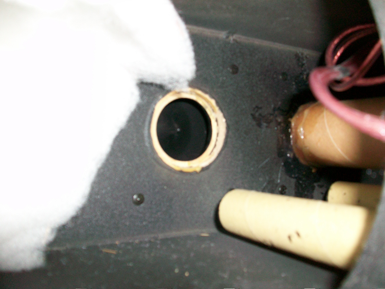

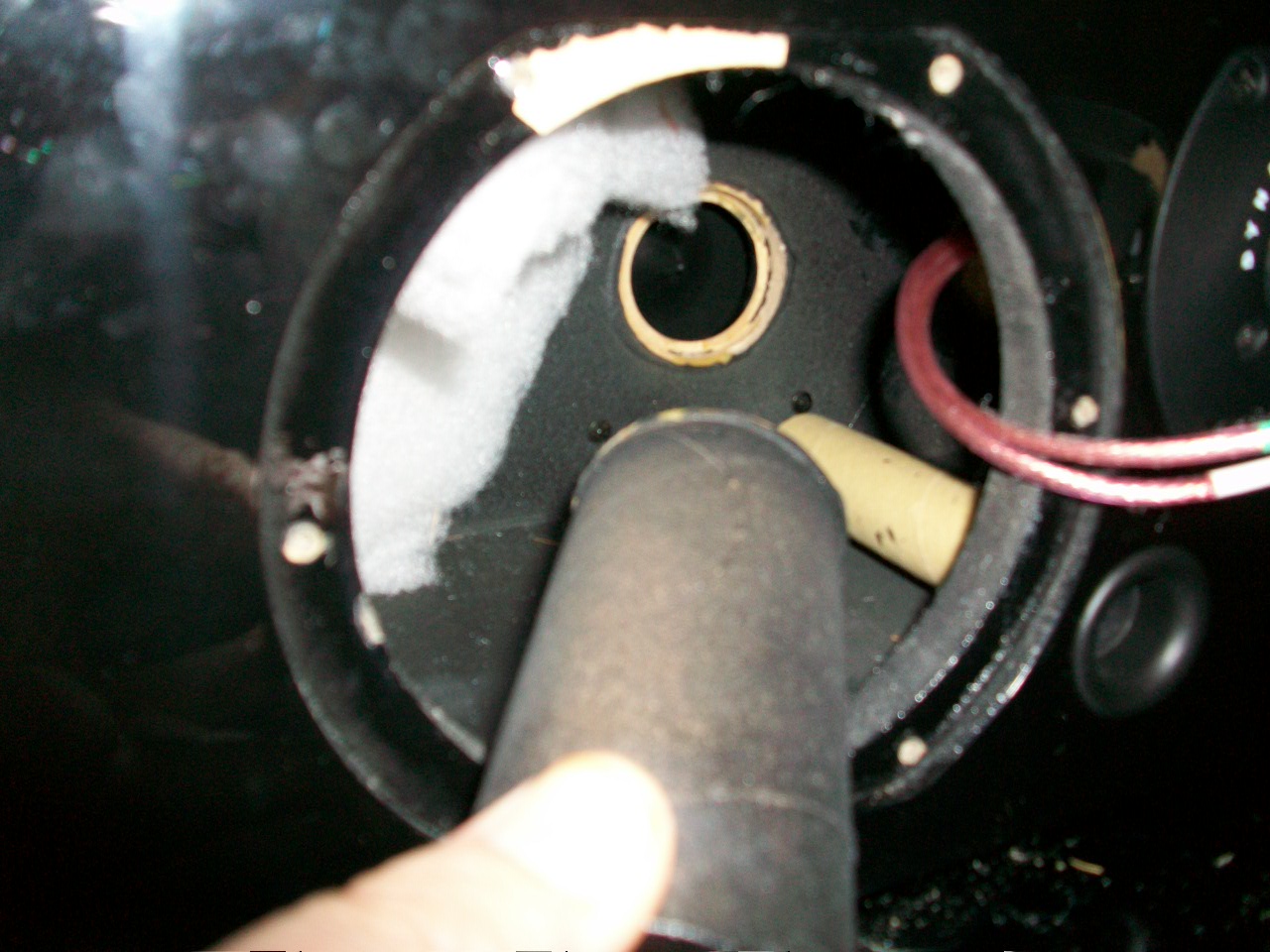

    I removed a woofer and discovered this:

    that explains it....good thing that you removed the driver....
    LSiC should sound as good as LSi9 or LSi15 as that was my experience....
    report back after everything is put together....

    pitdogg2 Posts: 26,957
    edited November 2013
    Looks like it has already been repaired once. Could it have been dropped?

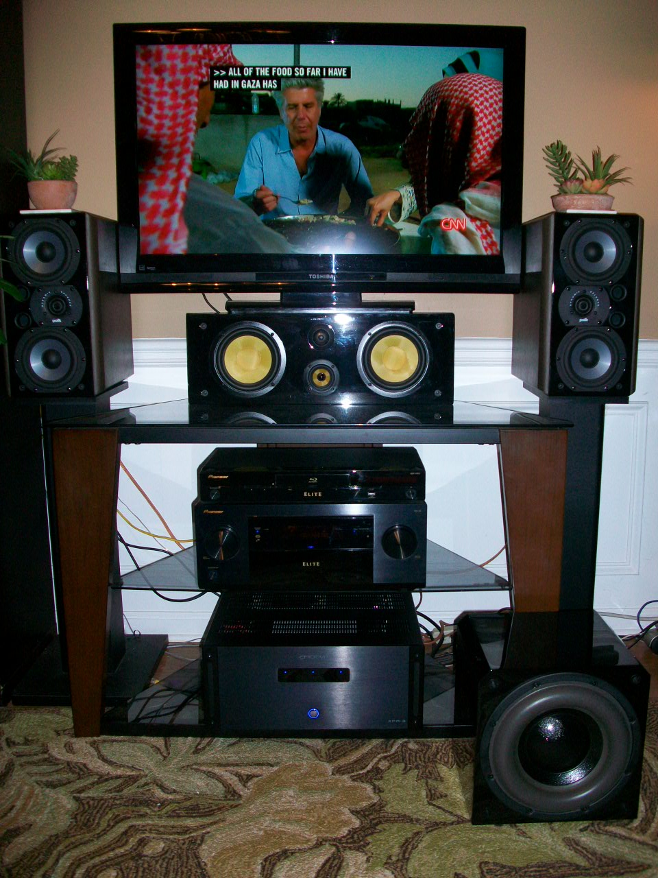

    Just another note... Are your lsi9's setup backwards? (left is right, right is left?)
    Garage | Polk Monitor 5B's
    That is what I am thinking. It was shipped, but packet very neatly. It might have been dropped years ago. Then one horn fell off and glued back. Then the other one did - either before the last shipment or during.
    No matter. I glued the horn back on. There were 3 small damaged areas on the enclosure which I quickly took care of with a black high gloss spray paint. They disappeared.
    Here is how I look at it. Its impossible to find them new. They are at least 10 years old. The used one (on Amazon for example) are $499. About $450 + shipment on Ebay - so about the same.
    I got a fixer-upper for half that - $192 + $30 shipment. I spent $12.95 on it today at a local Lowes store - Gorilla glue and black spray paint. Plus about an hour of my time, which I really enjoyed.
    How does it sound? I dont know yet. It is all connected, but I will not crank it up until 24 hours have passed since I glued the horn, just to be on safe side.
    Then I will know.
    Gosh, I've spent the entire day figuring out why did you ask me this question. Then it dawned on me. Because tweeters should be on the inside and I have them on the outside, right?
    That is intentional. You see, Mikey081057, I dont have a lot of distance between the two speakers (left from right, not speakers and me). The whole system is squeezed in between a giant bookshelf and a computer workstation/media server. The clearance between speakers of my size should be about -7-8 feet. I have about 5 feet between the two. So to compensate for this shortcoming, I simply use left speaker for right and right for left. Internally they are identical. This way at least tweeters are an inch or two further apart than if the speakers were positioned correctly. Call it a poor man's speaker positioning. This is just my office HT, not a living room setup.
    Of course, the speakers get the correct amp input. The speaker standing on the left is connected to the left power amplifier output and the right one is wired to the right amp post.
    Its interesting that hundreds of people had seen this picture (I opened this cry for help in several online forums) and not one asked the same question! Great job.

    I guess it doesn't make that much difference in the practical world, but in the theoretical world of gimmickery having the tweets offset/off axis was supposed to be an audible difference but in the real world doesn't mean squat... But placement is critical ( i think you know that) with lsi's. I currently have my 9's as my rear surrrounds and have the right one on the right and left one on the left and reversing them didn't do anything that I could discern. The only reason I posed the ? was b/c I thought maybe it might affect something in your config

    Congrats on the Lsi-C fix. That's a great looking setup you have there.

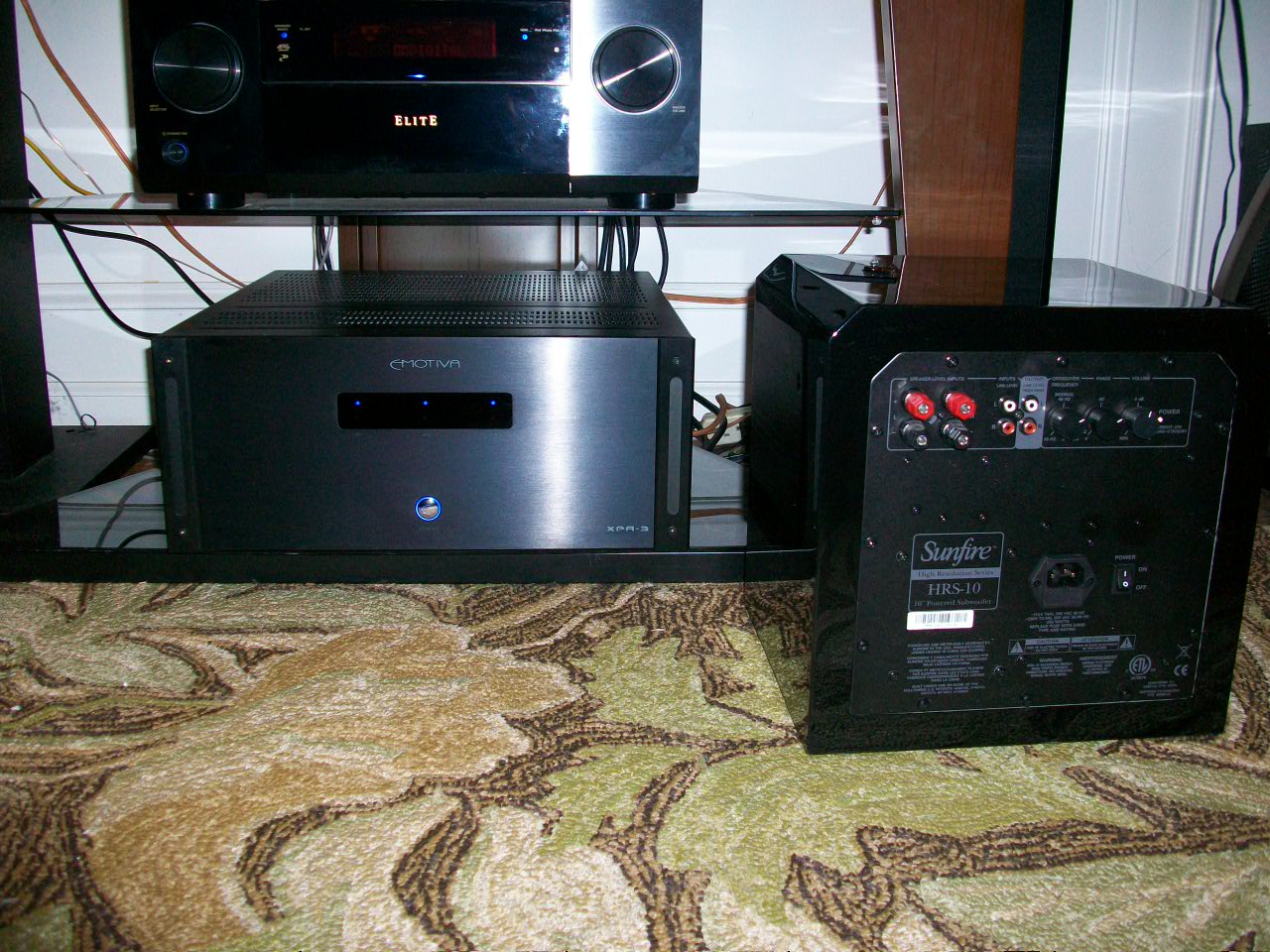

    The sub I have is a Sunfire HRS-10 : http://www.sunfire.com/productdetail.asp?id=16
    It is a 1,000W high resolution sub.
