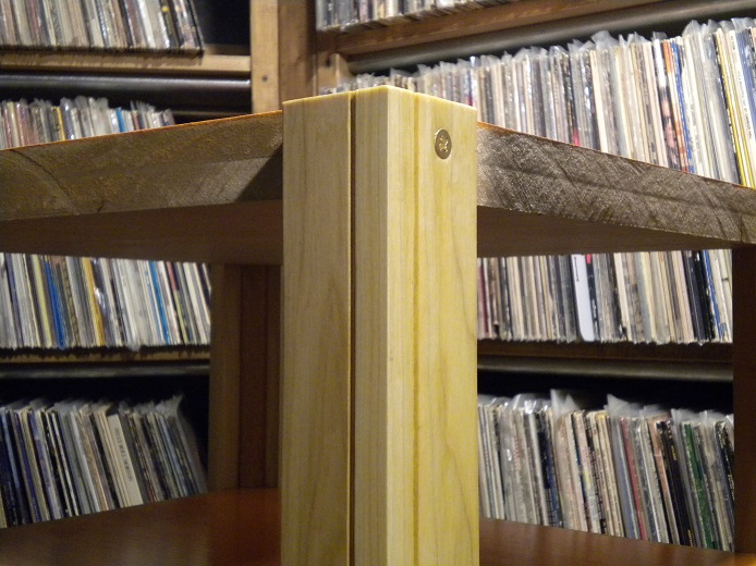

Let me 1st point out that I'm in no way a wood worker so please be kind. This is for a 2nd system where
I can change components or speakers as my mood dictates. Also it's not finished yet I still need to finish
the edges of the shelves. I used MDF (2- 3/4" pieces glued together to make 1 1/2" thick shelves) and
Poplar.
In case you guys haven't figured it out yet I like Orange
Poplar.

Nice work. I was thinking of building one of my own thanks for the design idea. What are the dimensions L x W x H and spacing in between the shelves ?
Good job! Building a new rack is on my list of "winter projects"
Happy Sunday to you nap,
The rack is 39" high
Spacing - The bottom shelf is 12" and 9" between the other 2
The shelves were cut 21" wide by 19" deep but will be bigger once I add trim
3/4" or 1/2" I haven't decided yet.
I had Home Depot do all the rough cuts so I came home with 8-2'x2' pieces.
These were glued and cut then to size using a straight edge clamp and circular saw.
The legs are 1x3 and 1x2 poplar joined with biscuits and glue.
I bought a cheap biscuit from Harbor Freight.
http://www.harborfreight.com/4-plate-joiner-68987.html
You can never get the glued edge straight so I ran the glue joint thru the table saw.
This way you can't see it wasn't exact and looks great. (at least to me)
I used pre-finished 3/4" oak quarter round between the shelves. This way all the weight
is carried down to the floor. So that the #14 x 3" brass screws are not the sole support
of the weight on each shelf.
