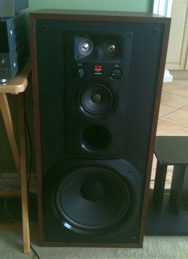

Pick them up today. Weigh about 75 pounds and are 39" high. Sound great to me. Never heard of them? Grew up with the Koss pro 4 headphones that sounded great. Wish I knew how to pop out the woofer dust cap on one of them? Tried my duct tape method to no avail? Thanks. D

    How about a vacuum to try to pull the dust cap, be gentle some have a lot of suction.

    I had a pair... The big weakness is the crossover switches. It's a three way toggle that was very fragile and broke all the time. Bass was pretty sold and the sound was pretty natural. The sonic weakness was it had average soundstaging and imaging.

    I bought a pair of CM 1030's back in 1977. Kept them until 2002. Jon s is right, the crossover switches were terrible. They constantly broke. I loved the sound. I had them connected to a Yamaha CR- 1020 receiver then a Yamaha A-1000 int amp. In 2002 they really started to fall apart and I could not get parts. I went with polk rti 800, 1000, 2000, lsi9 then lsiM703. In short I wished that I had kept them and fixed them, oh well

    Vacuum worked on larger woofer. Any hints on cleaning up the driver surrounds? The stickiness attracted lots of dirt and dust. My idea was soap and water w a toothbrush. Crossover network is crazy large for 1979? Thanks. D

    What a rats nest, that's crazy!

    Contact me at junk666email@hotmail.com and I can provide you with a Koss-original wiring diagram if you are looking to tackle (or have tackled) a crossover refurb - as well as other information and assistance. (The going rate for a pro refurb is ~$800 per pair. By now every pair will need to be refurbished. All resistors. Some caps - 1/2 the time - but you might as well have them done at the same time even if the originals are still within tolerance since the parts are cheap. It's the labour that adds up. I've had six pairs of CM/1030s done at SpeakerMart in Ottawa. I've had two other owners (one in Vancouver, one in the US) show me invoices for work they've had done and the parts and labour costs have all been essentially the same.)
    From the pics posted you have the "old" version of the CM/1030. (Woofers and mids are flush mounted. Mids have their own wooden sub-enclosure within the cabinet. The "new" version has surface mounted woofers and mids, with plastic woofer rings, and a plastic sub-enclosure for the mids - among other differences.)
    Glad the vacuum trick worked on the woofer's dustcap. Protect those drivers: there are no new original woofers and mids to be had. I do know of a source for new replacement tweeters (8 Ohms) and treble tweeters (4 Ohms): http://www.midwestspeakerrepair.com/. I've not seen or heard them myself, but other owners who I have been in contact with tell me they are an excellent match. They are certainly physically identical; with care you should be able to re-use the original plastic diffusers.
