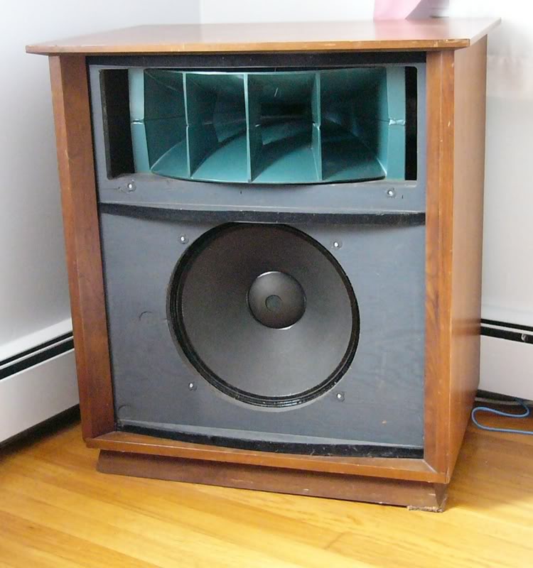

    Here's a photo of an 846A (16 ohm) Valencia (this one sans its rather delicate fretwork grille). This is essentially the guts of an entry level A7 VOT but in a smaller vented box. The VOT has an interesting box design which is vented but also horn-loads the woofer. The LF extension of the Valencia is rather limited (my guesstimate is ca. 70 Hz, realistically) - as is the HF extension - but in between, hoo-boy, do they sound nice with appropriate quality source and amplification :-)
    The ultimate VOT family member for home use may have been the Altec Nineteen. My own experience with the Nineteen is fairly limited, so I am still a little skeptical... but they do probably do better than the Valencia at both ends of the audio spectrum, and they may have generally better HF dispersion, too. They're big, heavy, and expensive, though (even compared to a pair of Valencias).
    http://www.lansingheritage.org/images/altec/catalogs/1976-home/page05.jpg
    Finally, and FWIW: I am rather partial to the Santiago - which is in essence a Valencia with a less-sensitive, sealed-box woofer alignment (and, of course, a different woofer) and a countour network on the HF driver to match its sensitivity to the sealed-box woofer and smooth/flatten its HF performance a bit. The best thing about the Santiago is that Altec fanboys eschew them :-) so the cost is much more modest compared to any of the above-mentioned VOT family members!
