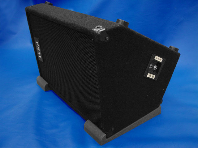

Just cover the wood with material, then sit it on top of a piece os think open cell foam: http://www.foambymail.com/acoustical-foam-products.html2.2 Office Setup | LG 29UB55 21:9 UltraWide | HP Probook 630 G8 | Dell Latitude | Cabasse Stream Amp 100 | Boston Acoustics VS 240 | AUDIORAX Desk Stands | Sub 1 - Mirage Omni S8 | Sub 2 - Mirage Omni S8

http://www.foambymail.com/MIW/monitor-isolation-wedge.html
$9.99 for the 4 pack, $14.99 for the 8 pack is you want a flat surface.2.2 Office Setup | LG 29UB55 21:9 UltraWide | HP Probook 630 G8 | Dell Latitude | Cabasse Stream Amp 100 | Boston Acoustics VS 240 | AUDIORAX Desk Stands | Sub 1 - Mirage Omni S8 | Sub 2 - Mirage Omni S8
