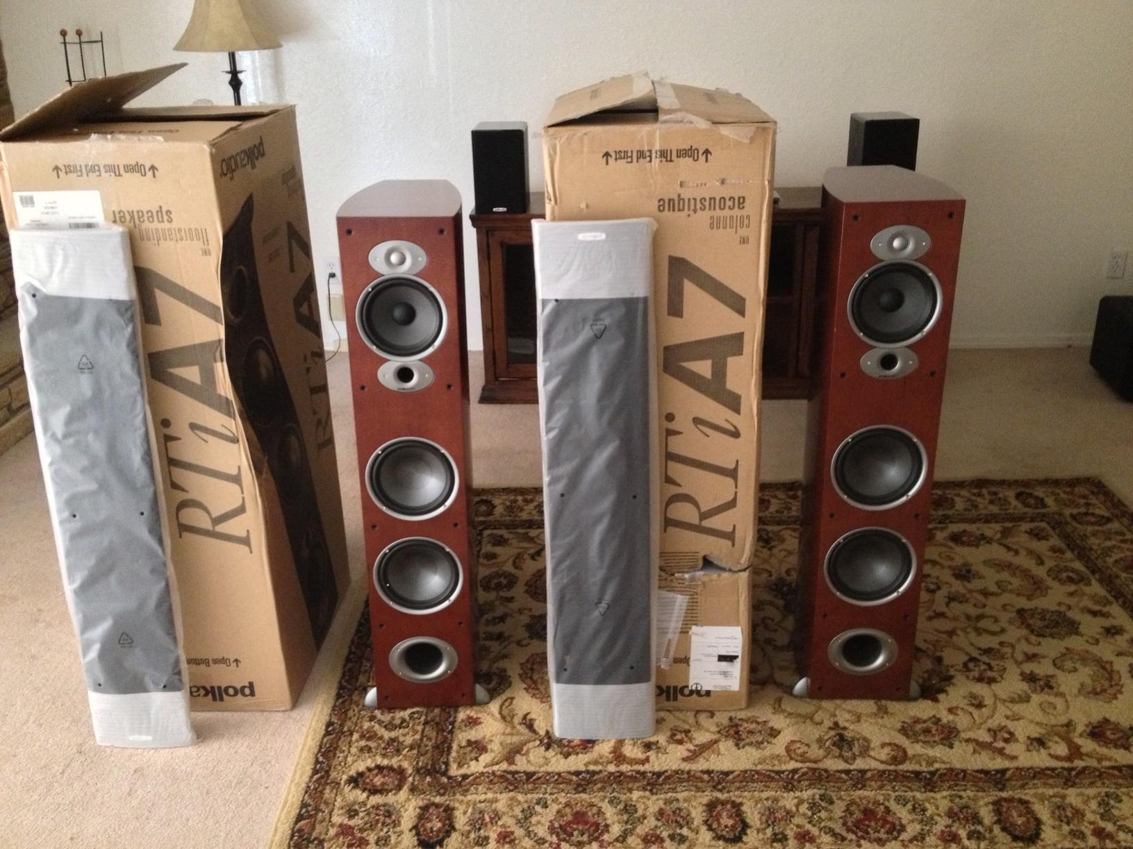

Delivered today and they sure look and feel beautiful!

I'm sure you're going to enjoy those, have fun!Home Theater
