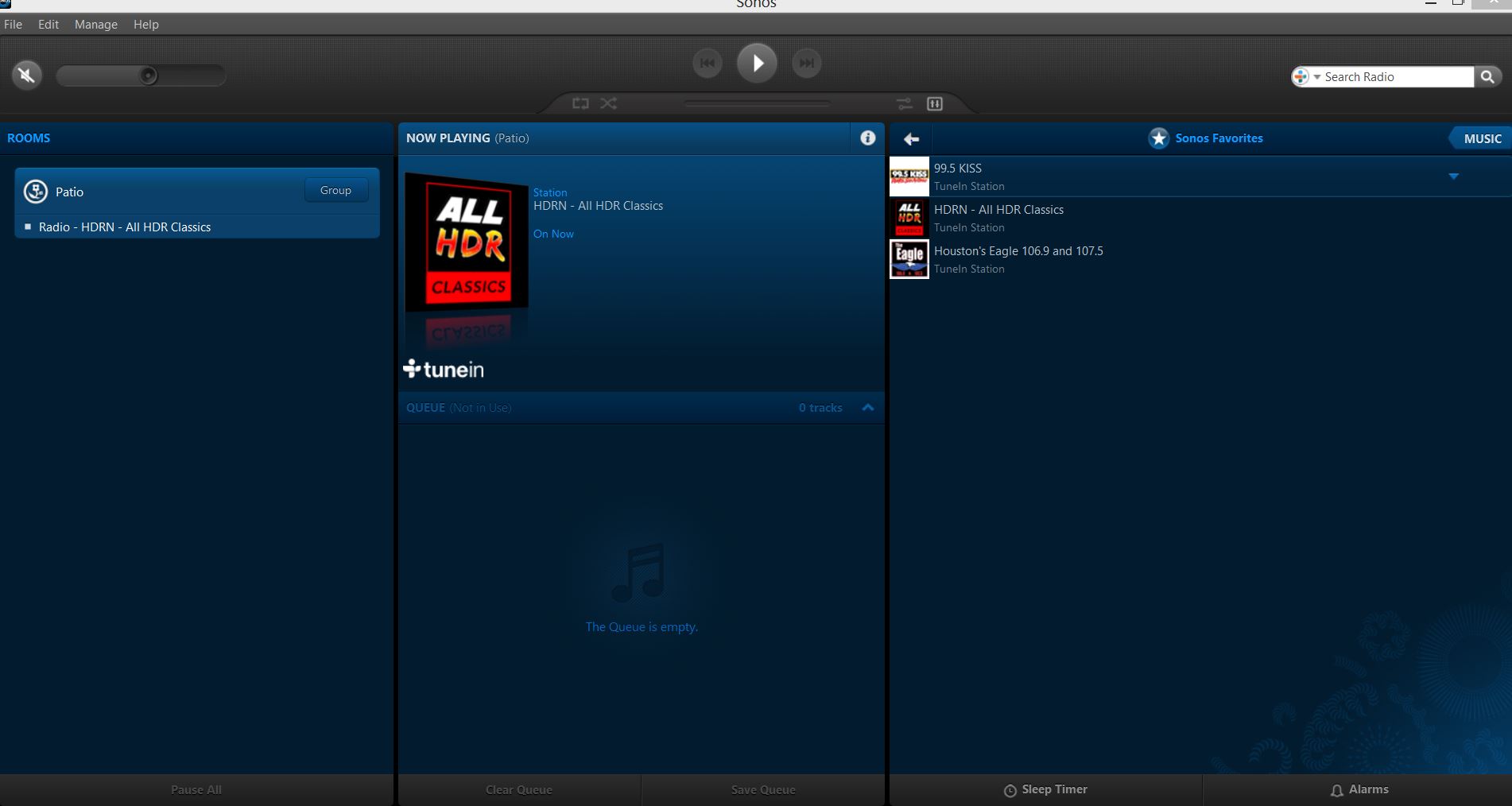

    txcoastal1 Posts: 13,505
    edited August 2013
    Here is a screen shot from laptop control
