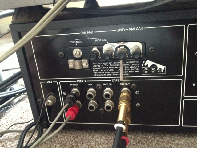

    Shoot, it only has the tape out option (see pic below). Is there another way to get the output to the speakers, or is a new receiver required?

    There are "speaker level to line level" adaptors around, but that would compromise the sound a bit. Why not consider a reasonable priced preamp or preamp/tuner to go with the Hafler? Certainly Adcom comes to mind. That would be a definite step forward instead of going with another receiver, which is a step sideways.
