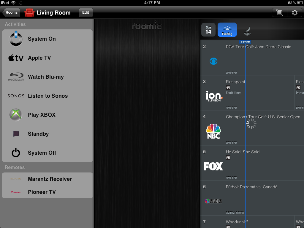

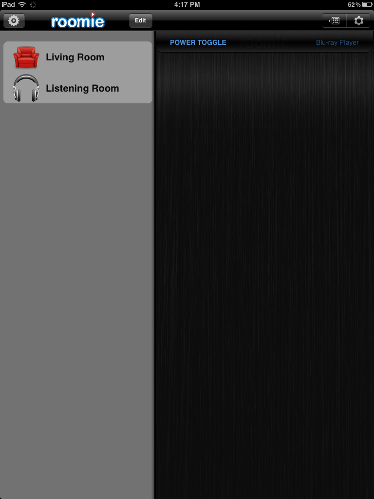

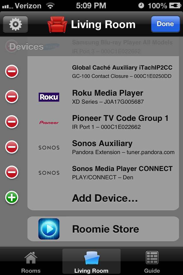

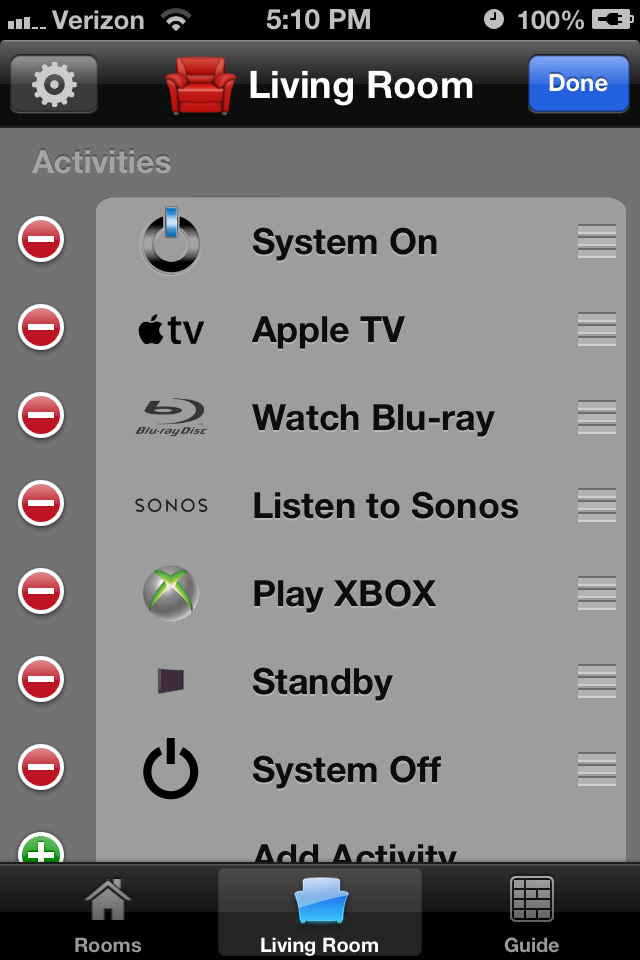

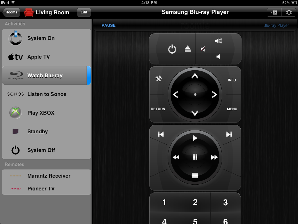

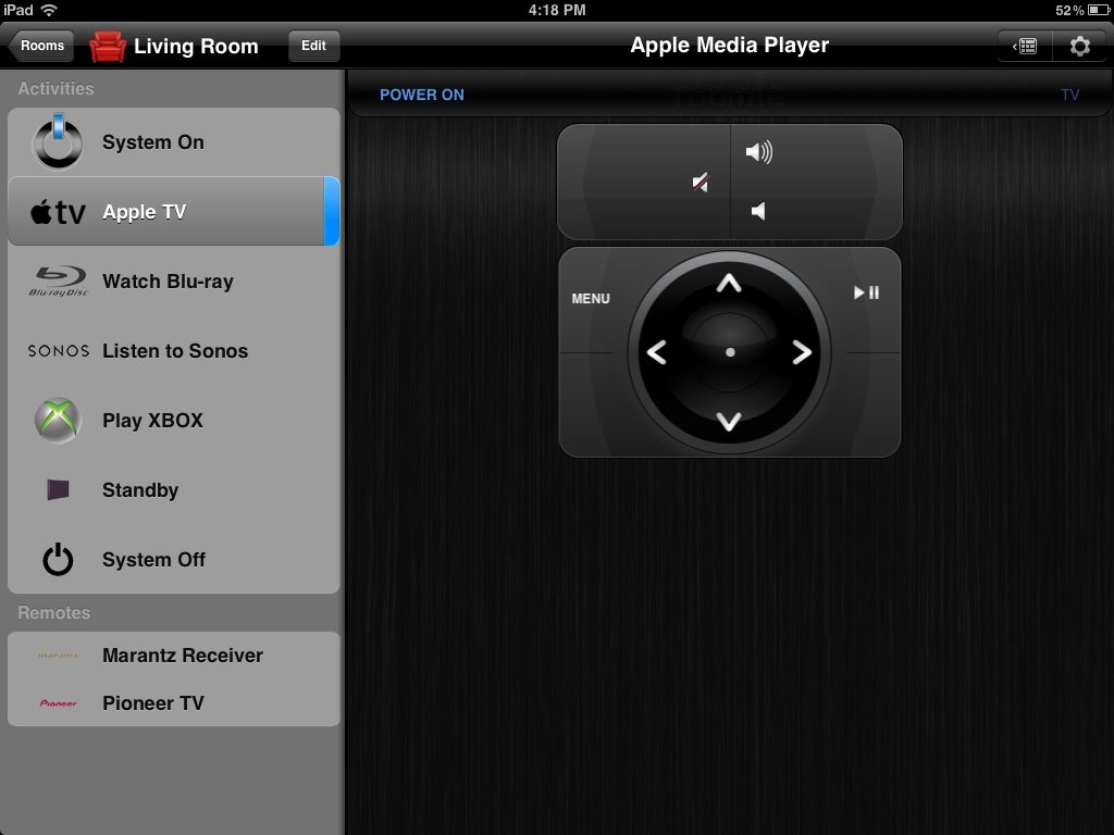

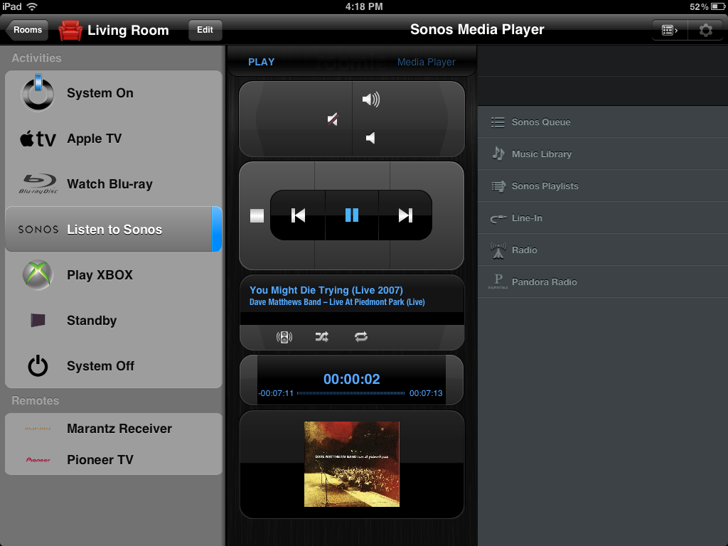

    Thats just some of my system. Roomie will generate all the pages for you, you can even add buttons.

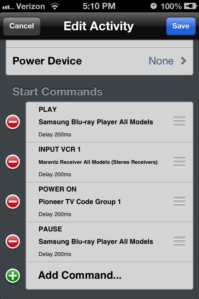

    You do have to make the steppers yourself. You just go to the activity you created like "watch a bluray" and click on a green + and add each command from any device you want. So for "watch a bluray" I have Turn TV on, Turn receiver on, tv HDMI 1, receiver input DVD, bluray power on. Its very nice and easy to use. if you have a device with a Enet input (IP control) it gets even cooler. The remote will give you volume feedback ( show the percentage of volume your at, status, input, surround mode).
    Something like this

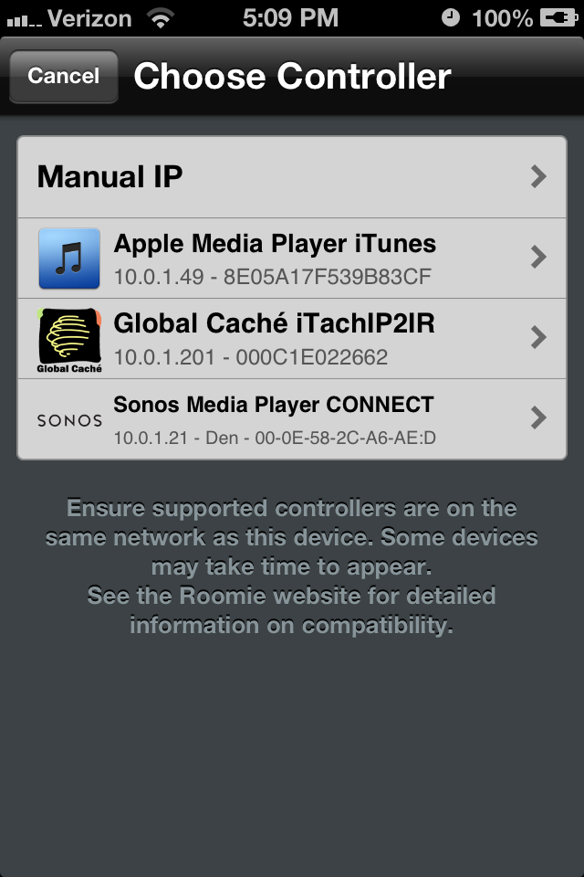

    To add IP devices it even faster then IR. when you click "add a device" it will show you all the Network devices.
    like this
    Its smart too. Some devices like Sonos cant be set to static IP, so the roomie will grab its MAC address and remember it/ update the IP as needed for IP control.
