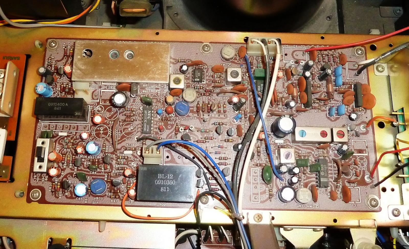

    Also what is that black switch on the board on lower left?

  • Posts: 200
    edited July 2013
    to answer your question about the little black switch:
    the board you are looking at is the FM tuner board. the little black switch is for de-emphasis. probably on/off. best to just leave alone i would think as it is probably set to on.
  • Posts: 2,546
    edited July 2013
    It has 50uf --> 75uf on the button and it's set at 75uf.
