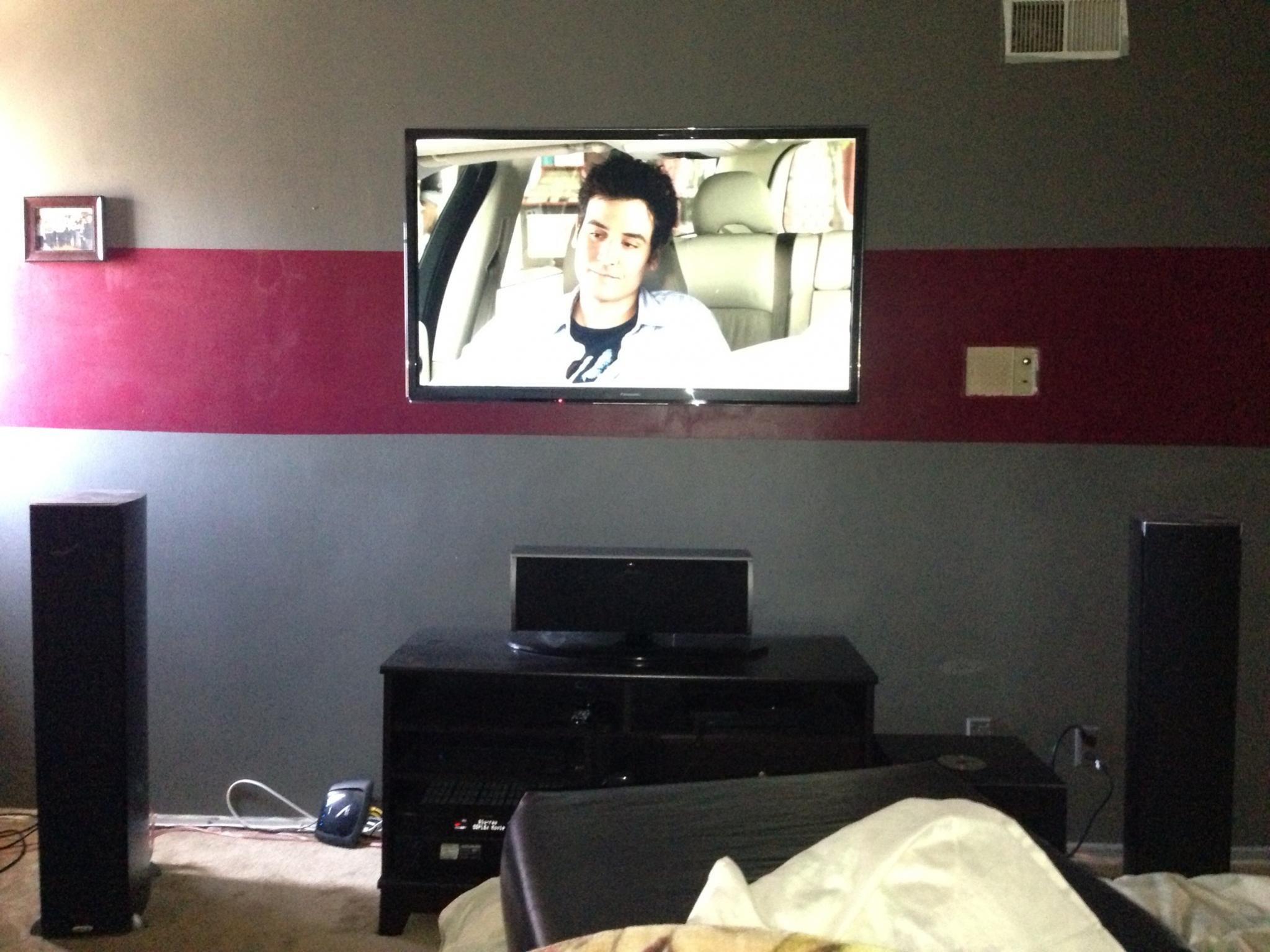

Are my fronts too far apart from one another?
oleon621
oleon621 Posts: 178
edited May 2013 in Speakers
Seating distance is about 10 feet and so are the distances from one left speaker to the right speaker
Front- RTI A7,(powered by ADCOM GFA 5500)
Center- CSI5,
Surrounds- RTI 6 and Rear Surrounds- TS 15.
TV-Panasonic P55ST50
SUB-SVS PB10-NSD and PSW505
Receiver- Yamaha Aventage RX-A2000

    They are not too far apart, that big red border against the grey wall was the same color scheme of my bedroom in the 80's. I also had matching grey black and red drapes and bed spread
  • oleon621
    oleon621 Posts: 178
    edited May 2013
    Thanks for the input. Just wanted to make sure they weren't too far apart. I actually got the paint scheme from some magazine. Maybe the 80's are back :wink: I really like it. Should I have the RTI's close to the wall? They're about a foot away from the wall and that's probably the most I can do.

  • Face
    Face Posts: 14,340
    edited May 2013
    Try toeing them in more and see if they sound better to you or not.
  • oleon621
    oleon621 Posts: 178
    edited May 2013
    Face wrote: »
    I'll give that a go. Should I run my YPAO system again after the toe in?

  • zane77
    zane77 Posts: 1,696
    edited May 2013
    Yes, you will want to re-run it after any changes

  • ken brydson
    ken brydson Posts: 8,980
    edited May 2013
    Don't look too far apart to me. Toe in would be my suggestion as well.

  • oleon621
    oleon621 Posts: 178
    edited May 2013
    Ok guys so I did the toe in and I feel that the sound stage is directed more at me. Of course I sit in the sweet spot but now the sound just meshes well together in the center. Thanks

  • specd_out
    specd_out Posts: 505
    edited May 2013
    mine are just a far apart. I prefer it for HT. For music they should be closer together but its not a huge deal. You may want to get a wider tv stand. This way the speakers wont look so far out

  • theshawn
    theshawn Posts: 70
    edited May 2013
    Depends on what you use them for, on the whole I don't think 10' is too far it's just the farther apart you go the smaller or farther out the musical sweet spot imo. Toe in helps though. I'd just play around with it til' you find the distance that gives you the sound you prefer. If you're mostly using for HT though then probably not as big a deal. Playing with speaker placement can have a bigger effect than some think so I would advise experimenting.
