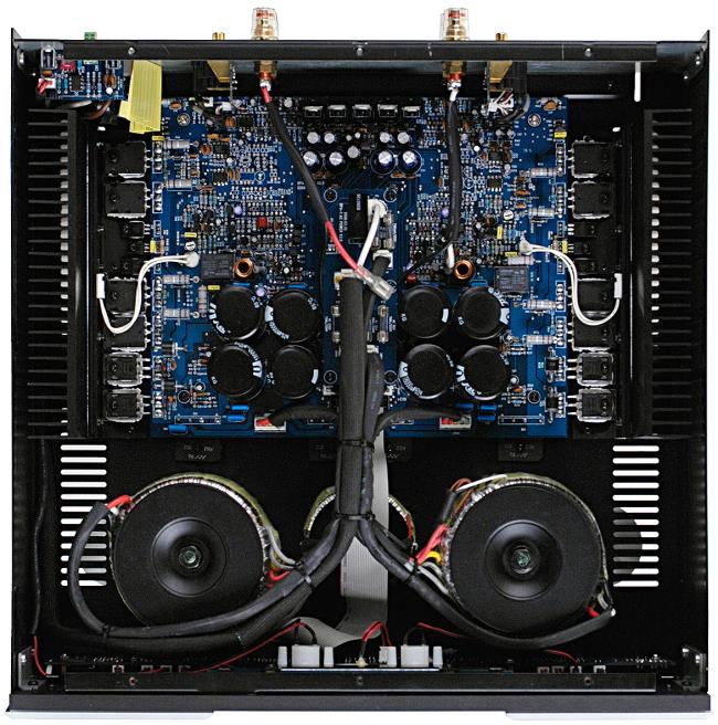

  • Glen B
    Glen B Posts: 269
    edited May 2013
    Looking at internal shots of the Emo amps, I agree with others that their layout is not mod-friendly. You have connectors soldered to the pre-driver board, and construction that involves a lot of disassembly, work that is best left to the most experienced and hardcore modder. For other than the most simple mods, its also good to have schematics/service manual, and I am doubtful that Emo will release such documentation for current products.

    Glen B wrote: »

    heiney9 Posts: 25,510
    edited May 2013
    Part of the issue is the actual amp topology. No amount of boutique parts can make up for shortcomings and short cuts in topology. You could certainly replace key caps, resistors or even rectifiers. IMO, the many gain stages, and heavy feedback (which is very common at this level of gear) is much more of a limiting factor than poor parts, but ironically the lesser parts mean more gain stages and use of techniques like negative feedback to help achieve some sort of acceptable linearity, etc.. making up for shortcomings in parts. Using better parts in key area's will probably lead to small improvements, but not as much as a redesign of then entire topology.
    Plus you'd need to know you way around inside and be able to make adjustments and circuit mods at the same time.
    But good advice to wait until the warranty is up.
