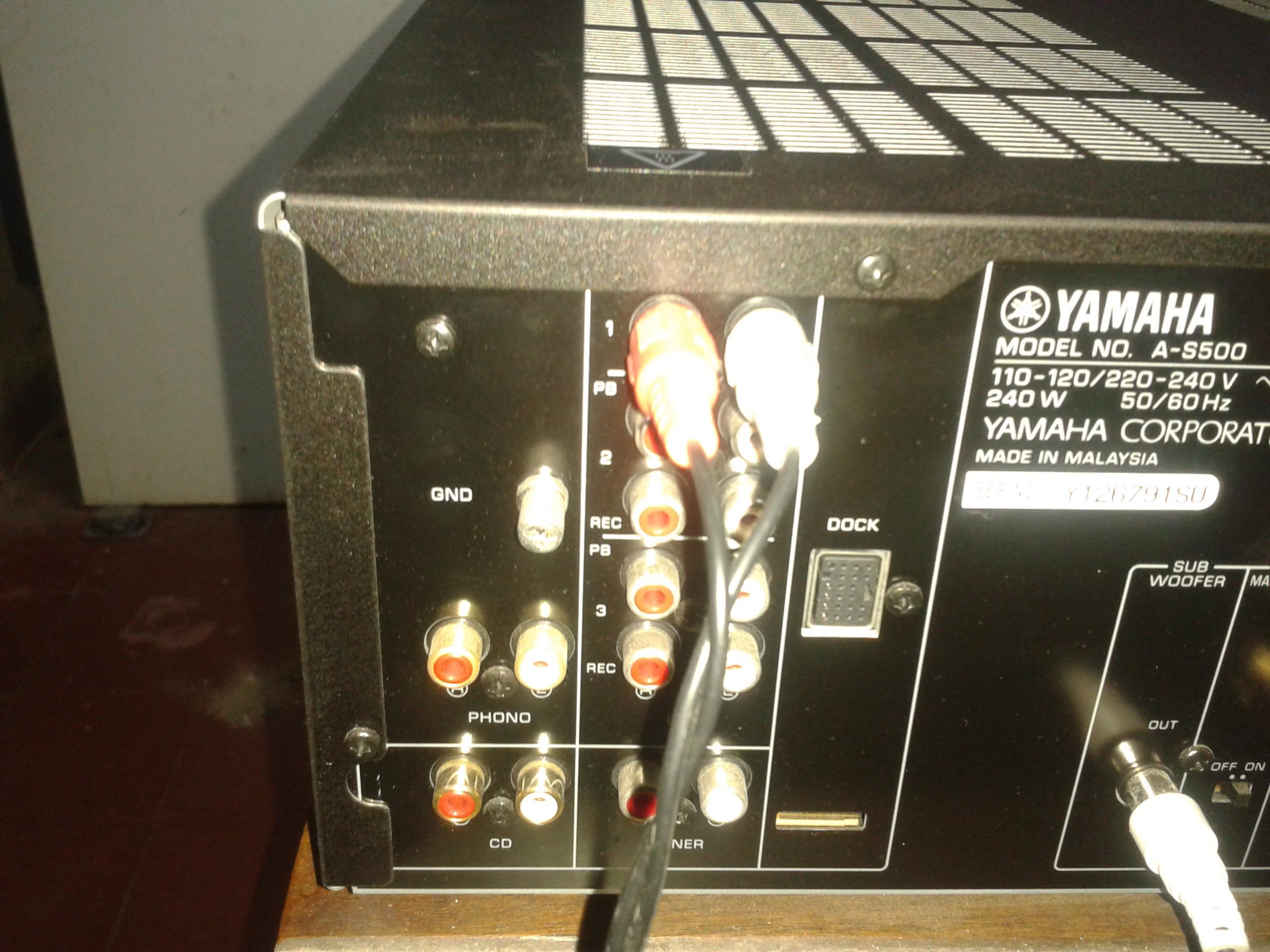

hello guys, i'm Brand new here and i hope you can help me with your opinions about my stereo system, i've got a Yamaha a s500 two stereo channels, i like listening to music and watching some movies eventually, but music is my life to tell you the truth, the fact is that my main speakers are a pair of the entry level polk tsi300 but they really sound good enough in my opini

Raf, welcome to Club Polk. You have your Yamaha amplifier correctly connected to the left input on your PSW110. You should understand that the frequency control on the back of the 110 isn't a full crossover; it just rolls off the response of the sub above the number set, but it has no effect at all on the TSi300 speakers(even if they were wired through the sub)and they'll operate over their full designed range. Since the TSi300 is rated by Polk to be down by 3dB at 47Hz this means that its response begins to drop off a little above that, probably in the 50-55Hz area. So, for the best blend between the sub and speakers the sub should match that by rolling off above about 55Hz. Since the lowest setting on the sub is 60Hz, that's the closest that can be done and the sub should be left at that lowest 60Hz setting.
As to the sub's volume control, many users set the sub volume too high. It would be best to have a sound level meter to match the volume of the sub and speakers, but if you don't have one, you have to try by ear. The sub shouldn't be so loud that it's obvious as a separate sound source; it should be as if the sub isn't playing but the speakers are putting out more bass. Although different music sources have different levels of bass, this is the way they were recorded, and you shouldn't have to try to change the sub level for each one.

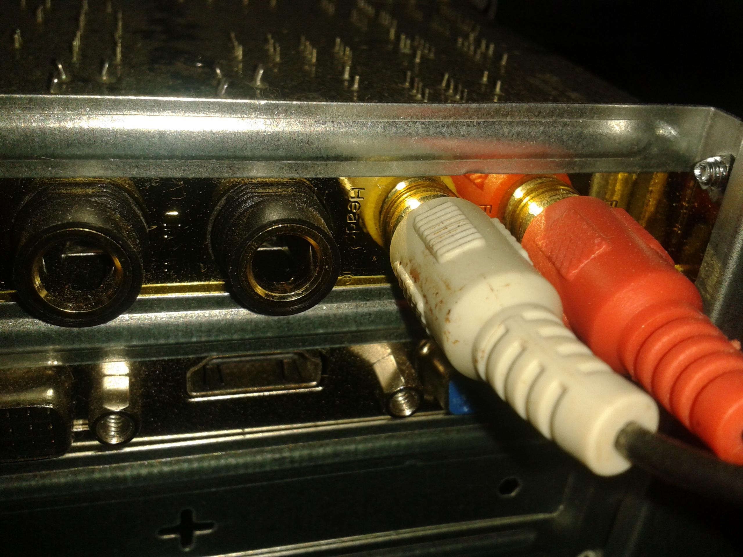

just a question about output connectors from the asus xonar essence txi, i have my yamaha integrated amplifier connected to line one input to the two rca connectors from the sound card left/right channels, i read somewhere about conecting the sound card from its headphone connector to get better fidelity, is that right? or you think the two analogue rca outputs from the asus are made to connect an external amplifier properly?, as you know this sound card has its headphone output amplified while the two rca outputs come just from the dac built in the asus, a cirrus logic as far as i'm concerned
or a burr brown im not so sure now, anyway both are good dacs according to several reviews
that's how i have my connection from the sound card to the yamaha a s500, as you can see there's a headphone output aside the white rca connector some say that taking sound from that amplified output you get more fidelity, but i guess left with left and right with right output/input - what do you think about my yamaha is totally an analogue integrated amplifier two channels for pure stereo system, not A/V

i think i have found a real pleasant sound from my tsi 300 and the psw110, anyway, some say although they mostly refers to hi end headphones, that connecting a macho stereo jack to two rca to an amplifier even, you can get a better sound from the asus xonar essence tsx, but then, what rca out puts stand for, i guess they are intended for two channel amplifiers like my a s500 or those powered multimedia speakers in the market, or are they right? besides i have just a 3.5 mm macho stereo plug to two rca so i need an adaptor that cames with the box of the asus, but in my humble opinion that will narrow some way the outcoming sound, a little bit confused there, i like what i hear now, but if they are right? that input besides the white rca is the one i am talking about, it is amplified for headphones up to 600 mv i think
Check if these 1/4" TRS are balanced or unbalanced outputs. They can be designed to do both.For Sale 2019:
