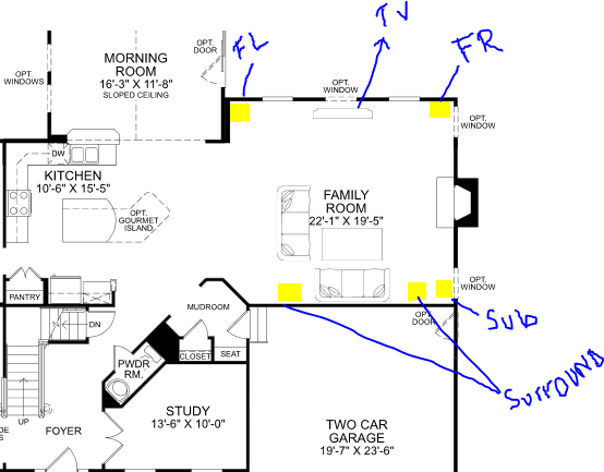

    This the room that I will be setting up the 5.1 and wanted to know from you guys if the locations that I have marked are correct placement for the speakers.
    Also, can I get away with bookshelf speakers in this room?
    Another question - Is there anyway I can put my media equipment, AVR,s et top box etc in the study room and still be able to control it from the family room?

    Personally I would put thr tv on the wall by the garage, and hang the fx's between the windows. You could place your fron mains in the corners indicated, but remember you want the tweeter aimed at a certain spot. Where ever it is that you designate the best room in the house. As faras the sub, corner placement is good, but you'll want it about a foot away from each wall.
    You have a really big room for a sub, with the open floor plan the sub will use that rooms air volume also. I think one 12 inch sub will be alright, but a second would be better. Just have a feeling you may have a pretty big null in that room tah sub placement may not correct, unless it is huge. May want to consider doing the sub crawl before you decide placement, I think it is definately needed it in your application.
  • eclypse
    eclypse Posts: 595
    edited April 2013
    If he places the tv where you mentioned on the garage back wall, he will then get light glare from the windows.
    The garage wall is not ideal as the light for window will hit the TV.
