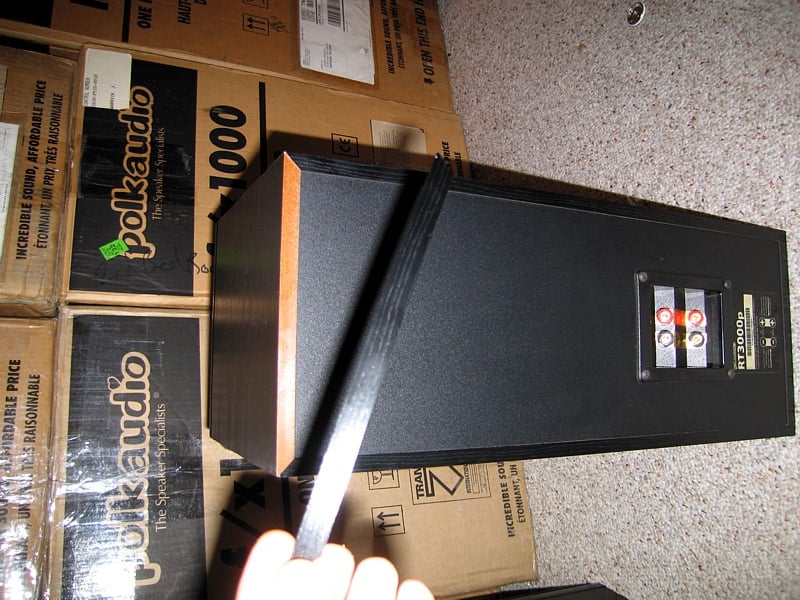

I wanted to see what everyone was using to re-glue the rear corner trim pieces on Polk speakers?
I have some Rt3000p satellites with loose trim pieces and need to glue them back on.
Super Glue doesn't seem to hold up.
What should I try next JB Weld?
