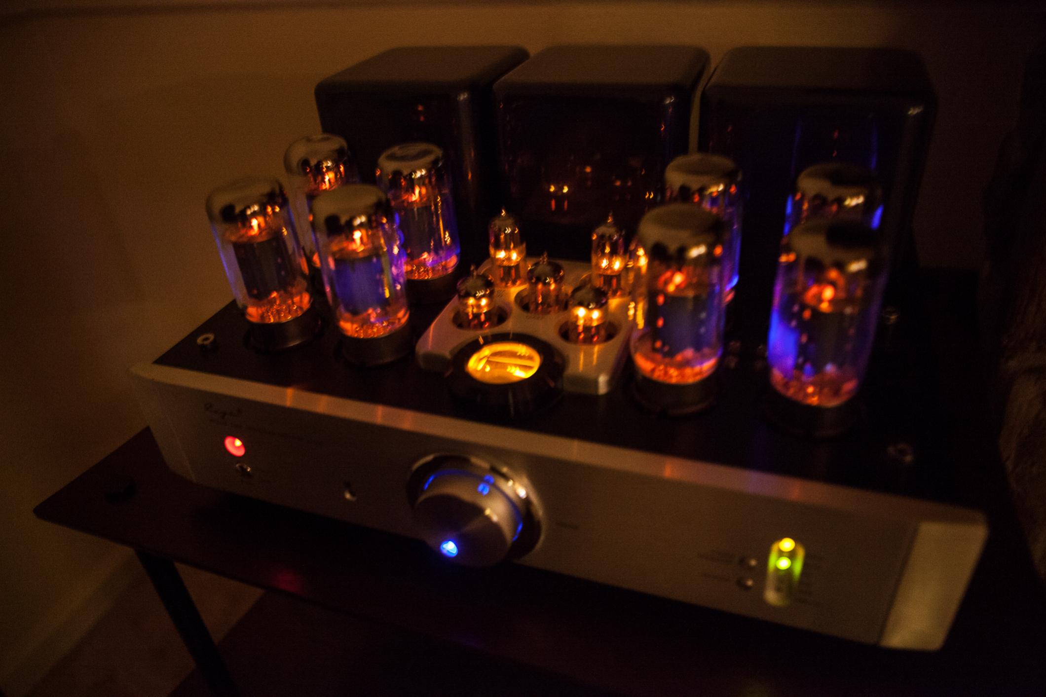

Bought a 2nd hand Cayin a100-t integrated amp. The seller listed it as 9/10 but it's actually a 7/10 on agon's rating. In addition, he shipped with the tubes and cage installed which caused some additional scratches during shipping. Then I replaced the stock output tubes some NOS winged c 6550, the moment I turned on the amp, there was flare from one of the tubes which seemed to blow out one channel. :redface:

    and,, was it the tube or bias resistor or?

    does the amp have any fuse protection? hopefully nothing too bad happened as sometimes tubes can go.
    And I'm sorry but its stupid to ship with the tubes installed. I got my VTL's the same way and wasn't too happy as it can cause issues. I didn't have any but I've seen some other things like this happen. One just recently was on a VTL pre amp that was shipped with the tubes and the buyer got it with them rolling around and the scale wasn't followed either.

    no fuse protection so I'll have to bring it to a shop for evaluation/repair

    That thing has got to have a fuse, are you sure it doesn't? In my Jolida the first time a fuse blew I saw the light from the fuse blowing and thought it was from a tube. Did the original tubes work? Did you re-bias the amp when you changed the tubes?

    If it has fuse protection, then it must be inside the amp. I haven't tried to open it yet as cayin noted no user serviceable inside. The original tubes worked. The right channel went dead the moment I turned on the amp so I didn't even have a chance to bias.

    Chances are you had a bad tube that took out the bias resistor.
    A multimeter will very the resistor and a tube tester will verify tubes function

    When I change tubes I normally set the bias to its lowest voltage, then replace the tubes, then dial it up to what it should be. I'm not sure how long you can leave the bias really high on a tube before you have problems but with this method it never happens. Certainly you should have some amount of time before the tube goes bad. I tend to agree with the above that maybe you got a bad tube. Everyone as far as I know always fuses the power because they don't want a bad tube to take out a bunch of componets.

    Thanks, madmax. Yeah, I forgot turn the bias to the lowest point before I put in the new tubes. The flare appeared the moment I turned on the amp. I will open up the amp tonight to see if there is any fuse inside.

    That's what I do as well. And I do the final set around 3am when the output voltage in my house is at it's highest between 122 and 124. Wall voltage affects the bias.
    When I got my first tube amp, I set the bias about 20 secs after power up. In less than a minute, the plate was glowing cherry red and I immediately turned it off. Any longer and it probably would have taken out the output transformers.

    This is good practice! In my rookie days I swapped power tubes w/o checking the bias. One of the 4 tubes started hissing and popping after about 30 minutes. After this happened I decided to check bias and it was high on that tube. Since then I do the above.

    Yup, I made 2 rookie mistakes:
    Bought untested tubes
    Didn't set the bias to its lowest voltage when plugging in the new power tubes

    I forgot to mention one thing in my method of biasing. I start at the minimum bias -then I let warm up for about 10 minutes then bring up to 50%. After about half an hour I bring up to about 75%. At the end of an hour I bring up to full minus a few miliamps. Later on I check to see if they are still at that value and if not I tweak them. Also, the next few times I power up cold I watch to make sure they are still set correctly. If I see the bias staying higher for more than a few minutes before being completely warmed up I tweak them back.-

    back in business after replacing the fuses and voltage regulator :)

    $144. My tube repair guy said the amp was modded with incorrect fuses which didn't work when the bad tube was installed. As a result, the blown tube also took out a couple of resistors and the voltage regulator. No help from the seller.

    Hate it when someone sticks bigger fuses into electronics without thinking of what might happen when failure occurs.

    supposed to be 100w/channel in ultra-linear and half in triode mode
