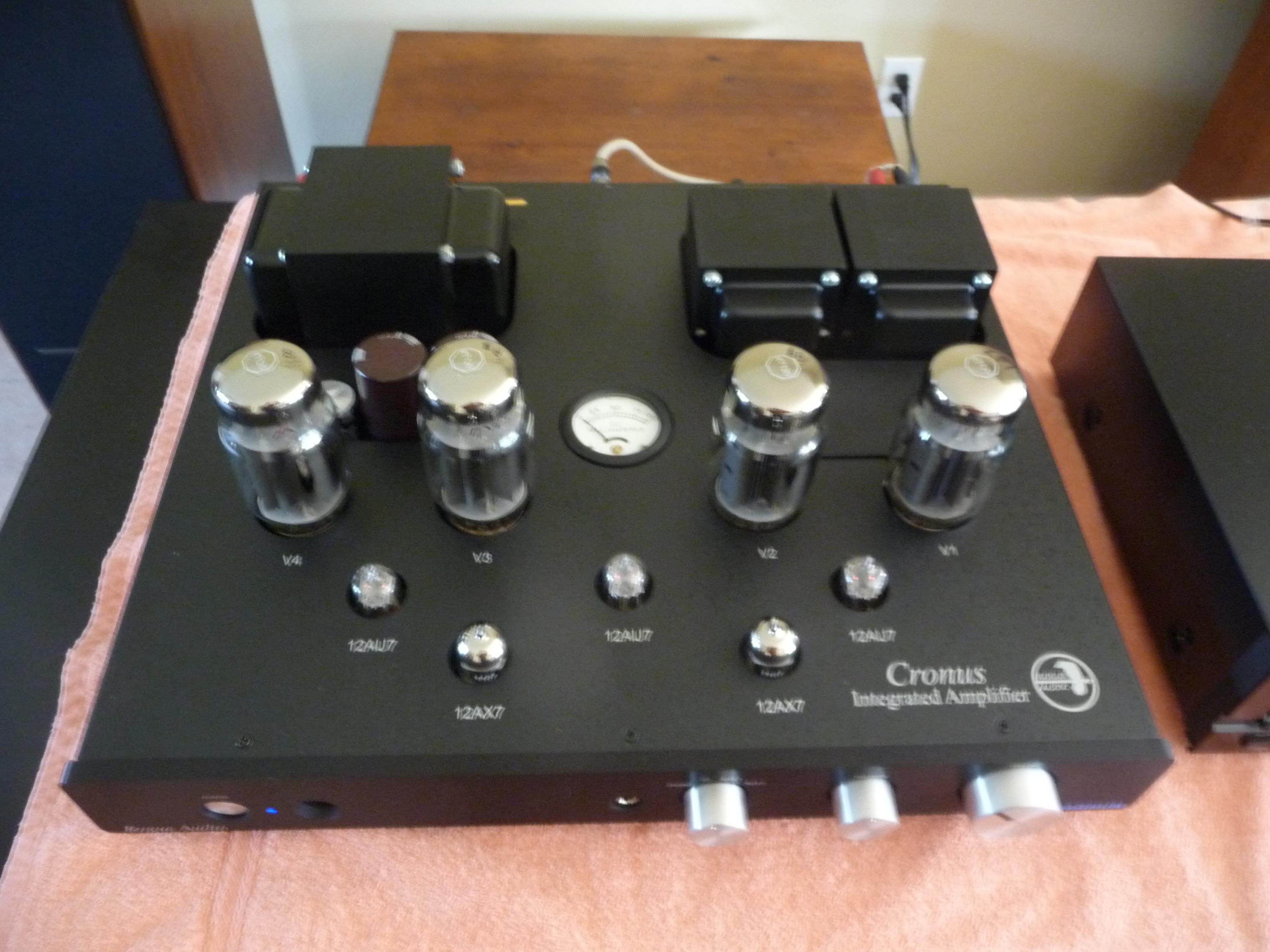

I got my 120's in the mail yesterday to upgrade from the original KT-90's [Cronus Mag].
Each power tube has it's own 1/4 amp slow blow fuse.
I biased each one according to Rogues instructions.
I let them warm up for 30min. before biasing,during warm up I heard a pop through the speakers.
I panicked and thought oh crap what happened, tube 3 blew the fuse.
Luckily the amp came with extra fuses so I replaced it. Mark at Rogue said I may have a bad tube. He said try the new fuse and I did with no problems so far.
What caused the fuse to blow?

With any power tube change I always set the bias after a short 2-3 minute warm up, just to get them close, the former bias point will always be different for any tube change. I then I go back after 30-40 minute warm up and fine tune.

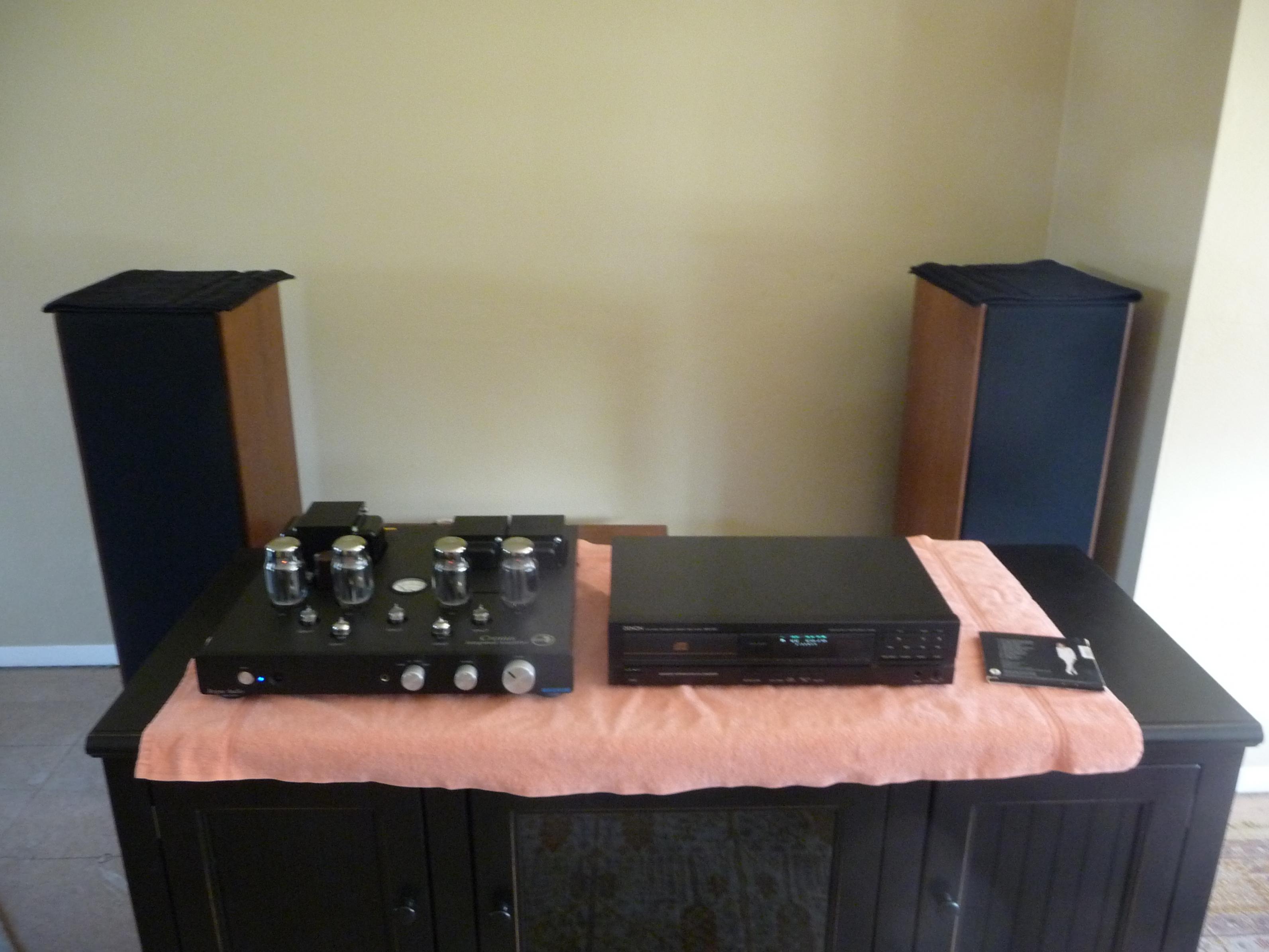

Looks good charley, did you end up with socket extensions and a new cover? Or just the extensions? -

Mike Reeter wrote: »Looks good charley, did you end up with socket extensions and a new cover? Or just the extensions?
Went ahead and got new cover from Rogue. After hearing horror stories about extenders I didn't want to risk it. -
