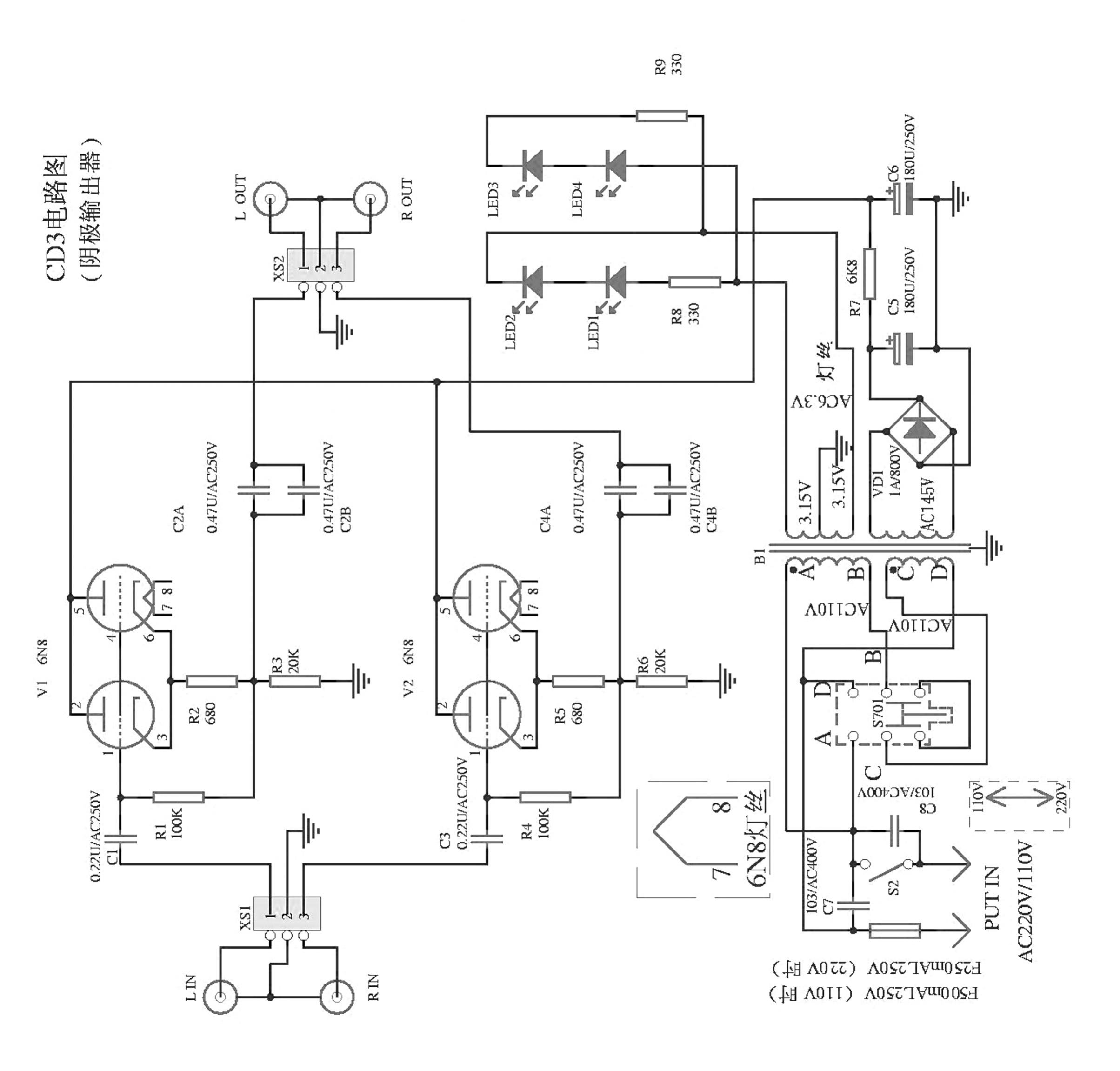

I'm going to be upgrading the 0.47uF and 0.22uF caps, but I'm wondering if there would be harm in changing the two input 0.22uF caps to 0.56uF, or something similar. I'm not quite finding the caps I want in that value, and I know you can go with larger capacitance in some situations without issues.

    zingo wrote: »
    That will be fine.

    Not sure why the paralleled .47uf's on the output?A single 1.0uf would be simpler and cheaper.

    Not with the caps I bought. :) I don't know why they did that either, but the board is layed out very nice to accomodate all the caps. I found a guy on ebay who sells NOS ANSAR SPA and PPA caps for a great price. All 6 caps were $10 shipped, so I'm not complaining.
