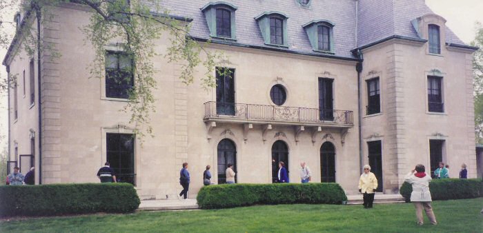

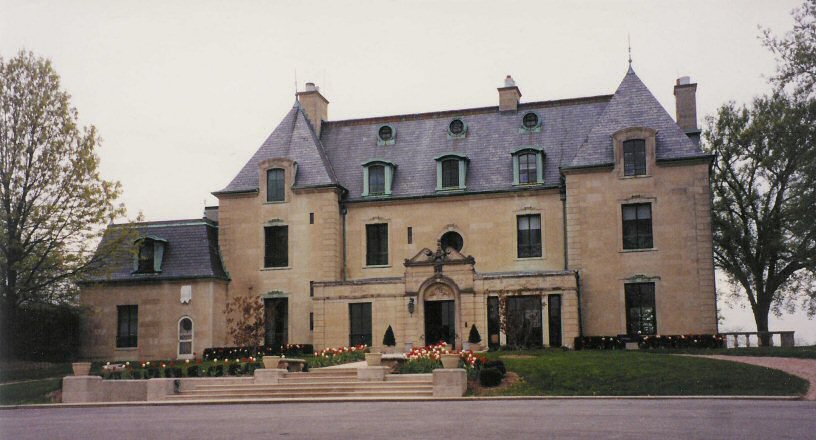

    BlueFox, you can do what a family in our little berg did back in the day. After building a French-style chateau, Mr. Desloge decided that, darn it, a basement would be a swell idea. So they lifted the entire mansion on steel I-beams, dug him a basement, and then lowered it back down. He was happy.
    From the front:
    From the rear:
    Bluefox, Desloge was in the lead mining business. You might consider taking up lead mining. Although, when the locals started questioning how the heck he could afford to build his palace complex during the depression doing lead mining, he added, "Uhm ... oh, I do silver mining, too, out in Colorado". He didn't mention anything about smuggling booze from Canada down the river and unloading it on his property. You might need to consider smuggling booze, too. Raising a house isn't cheap.
