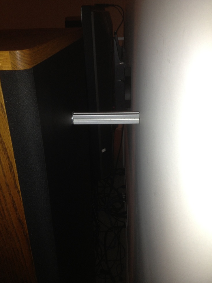

    I have the original ones that came with my speakers. Brackets came with that is are screwed to the wall with wood studs behind the sheet rock.
    The bracket mounts to the wall with two screws and then has a threaded center for the all
    thread and locking nut. It sets them fairly solid and keeps them from being knocked over. One other thing is
    they are easy to move just unscrew and slide on carpet.

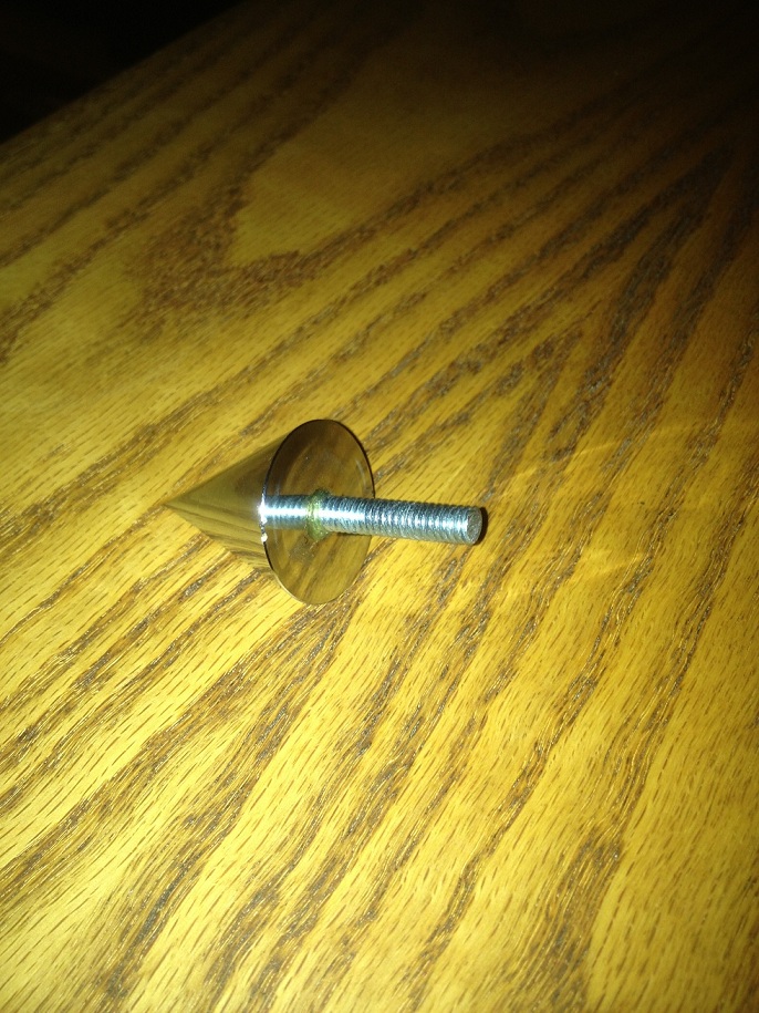

    I bought some inexpensive Parts Express spikes and cross-tapped the existing threads to 1/4-20. I then inserted 1/4-20 rod with 2 parts epoxy. They are solid. The problem was that no matter how I adjusted the 4 spikes, the monoliths would still wobble somewhat (on carpeted floor board) when I applied a little force. I decided to remove the back two spikes and add a single support brace to the back. With the speakers weighing 155 lbs, this results in 77.5 lbf vertical and 8.5 lbf horizontal on each of the two front spikes and (by my calculation) 17 lbf (in compression) on the back brace. I added a large washer between the brace and the speaker to spread the load. Of course, the braces are not appying force directly to the drywall but rather are resting on 2x4 reinforcements installed between the wall studs. The results are amazing! The monoliths are rock steady and don't budge even a little when I apply force. I find the bass to be tighter but it's still early in my listening.
