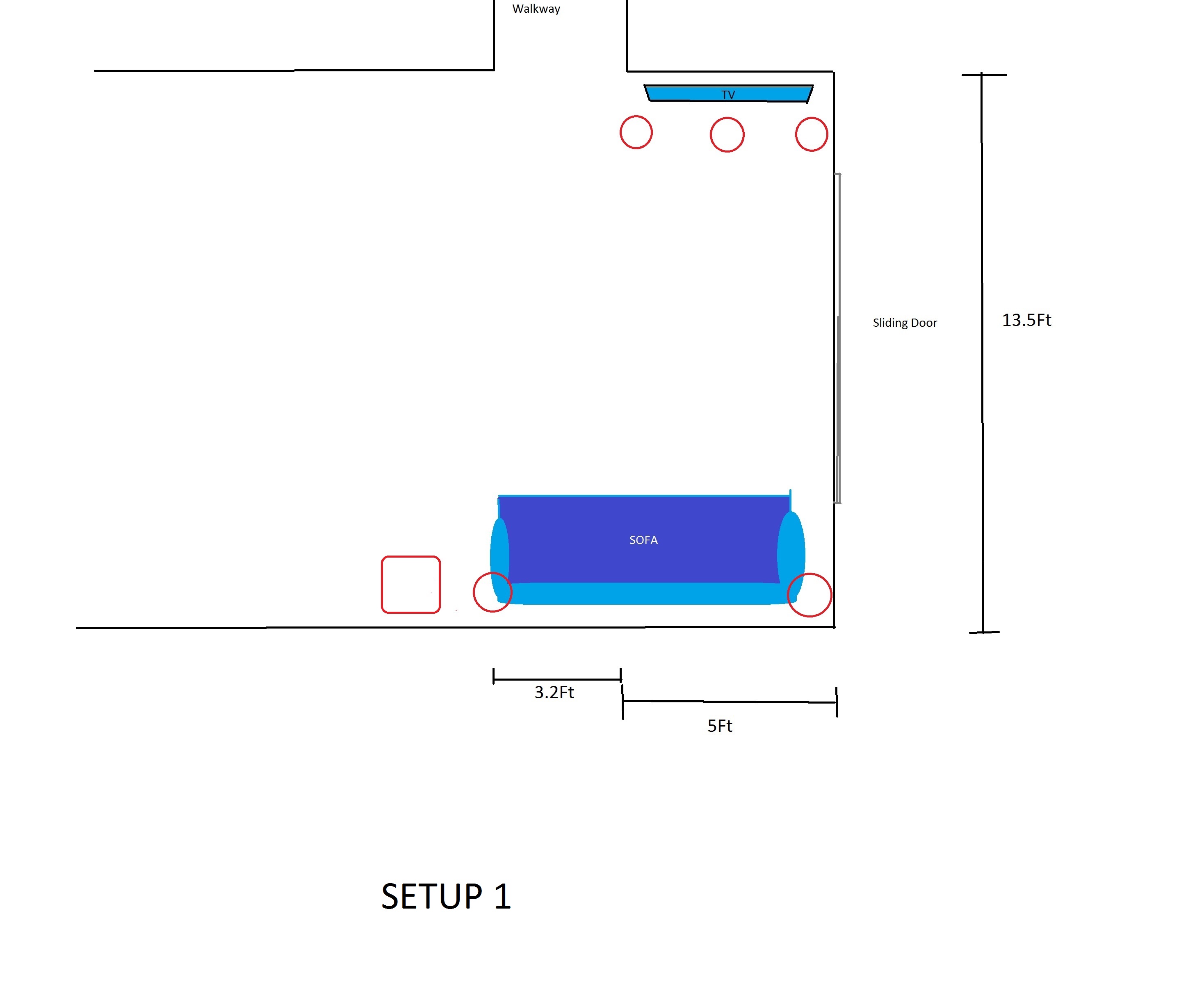

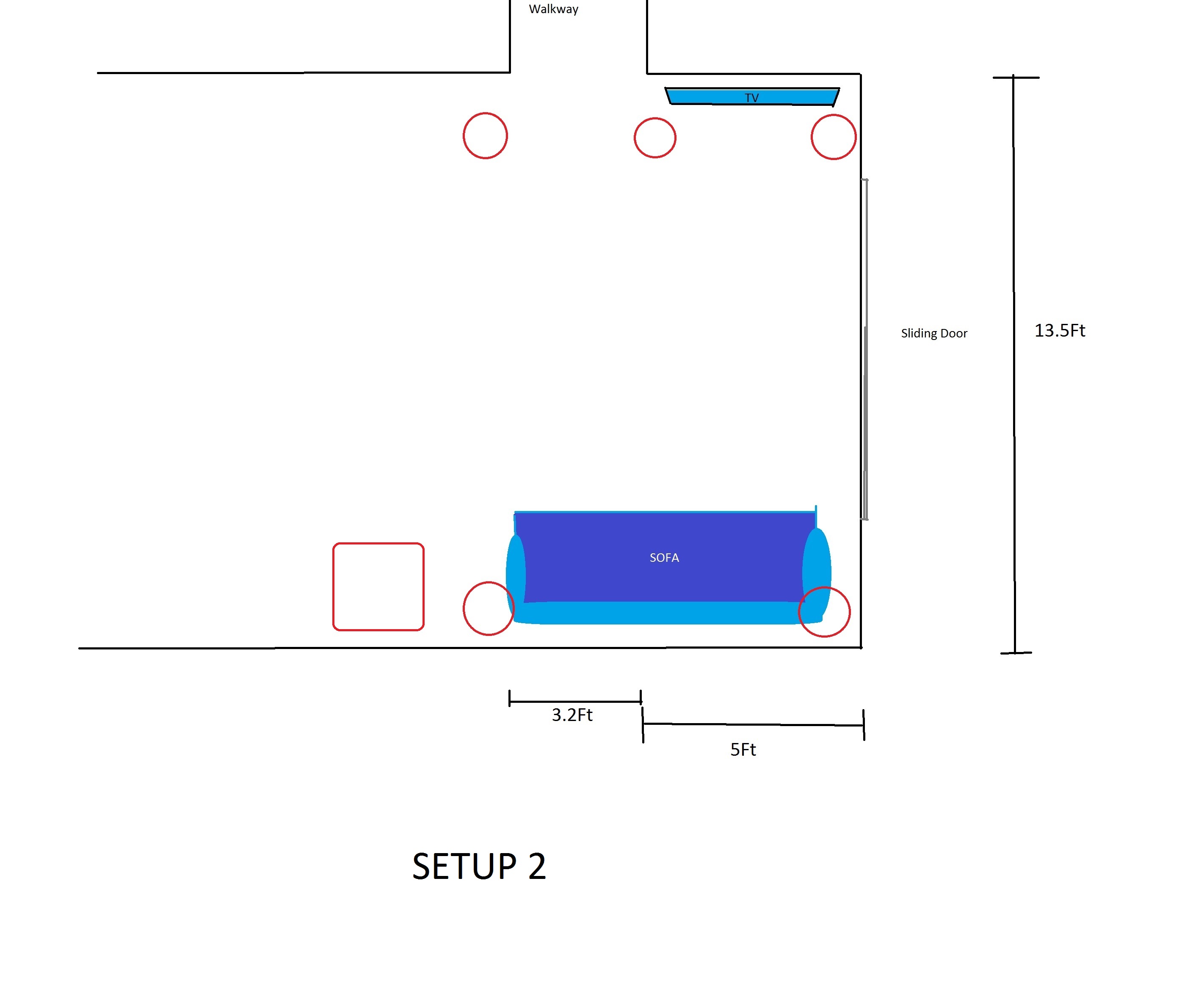

I am installing a 5.1 HT system to my new remodel room.
I have 2 Setup in mind, can you help me to decide which setup i should use, or there are better way for placement.
I will use RC80i for my Front Left/Right , and RC60i for Center, Real Left/Right .
Since i heard Front left/right is the most important speaker.
i will be using RCA AH16100SN 100 Ft. 16-Gauge Speaker Wire http://www.amazon.com/gp/product/B0029HHIDY/ref=oh_details_o03_s00_i00
will these wire do fine to run in wall/ceiling.
or i must get CL2 Rated In Wall/Ceiling wires which is much more expensive.
please help me on these questions
thank you

If you're going to run it through the walls you'll want the CL2 cable.
I'd go with the 14 gauge myself. -
CL2 is only really required if you are having it inspected for permit issuance.
You can typically get away with something like the Audioquest Flex series wire or the like.
Personally, I would avoid most RCA brand cable as it isn't always a copper conductor.
Anyway, just my 2 cents."Some people find it easier to be conceited rather than correct."
"Unwad those panties and have a good time man. We're all here to help each other, no matter how it might appear." DSkip -
+1, i bought some RCA an it was copper clad aluminum(CCA)2 Channel(work in progress):DAC: Schiit modi 2 uberAmp:Parasound 1200 MK IISub:RBH 1010-SEP Speakers: Monitor 5A peerlesscurrently running some krk rokit 3g since the HK pre outs died and i need to start breaking everything down to move in a couple monthsHeadphones:Source: tidalDAC: schiit modius epre: schiit sysAmp: AQ dragonfly black/ schiit magni2 Cans: Velodyne V-True, Grado SR225i, sennheiser x drop gaming headsetPC:DAC: schiit modius e(over spdif)pre: schiit sysspeakers: prenous eris 5 xtSub: Earthquake Sound MiniMe-P63most of my comments are passing on of info, im a noob, im just trying to help how i can, if im wrong or out of place to comment, dont hesitate to let me know "WITH WILLING HEARTS AND SKILLFUL HANDS, THE DIFFICULT WE DO AT ONCE, THE IMPOSSIBLE TAKES A BIT LONGER, WITH COMPASSION FOR OTHERS. WE BUILD - WE FIGHT FOR PEACE WITH FREEDOM"Seabee Memorial, Arlington, VA
