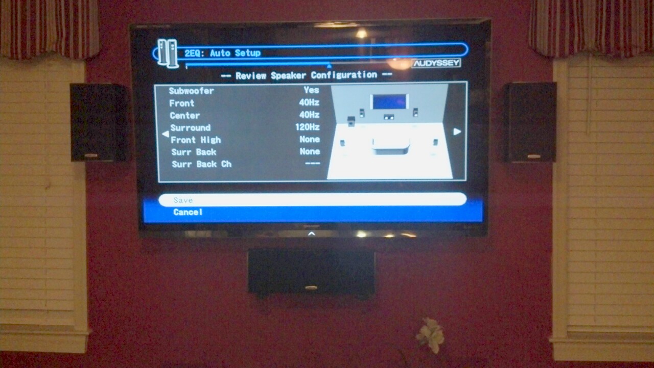

    Im actually looking for tight hard hitting bass. Sure some vibrate your fillings out is nice in addition, which this does., but it does not seem to have the pounding clean kickdrum type of sound.
    I ran Audiossy but have not really tested it as it was late.
    There is my results. Thoughts?
    My lowpass crossover was about straight up, which i think is 90hz. I put it at about 10:00.

    ecszone wrote: »
    ill test it tonight to see if its much better. At low volumes its not really fair. Although the PSW111 did not need all that high volume to really punch. maybe its just unfair to compare it to a 8" woofer.
    OK, if I'm reading your Audyssey screen right, you're asking way too much of your Fronts and Center channel, and consequently, not enough from your sub. You have the crossovers set for the fronts and center at 40 Hz which is way too low. With it set like that, you're only asking the sub to take everything below 40Hz, or in the case of the 550, that's just the very narrow band of about 25-40 Hz. You should never have the crossover set below the Lower-3dB Limit of the frequency response of your speakers. Most people here won't even set the crossovers down to 40 Hz with their large tower speakers that may have a lower-3dB limit in the 20s. Your Fronts (RTiA1s) and your Center (CSiA4) have Lower-3dB limits of 60 Hz and 65 Hz, respectively. Therefore, step one for you to try would be to manually adjust those crossovers on your Audyssey to a minimum of 70 Hz - I would start with 80 Hz though first and maybe even go up to 90 Hz. Leave the crosssover for your surrounds at 120 Hz. Then, set your Low Frequency Effects channel (LFE) to 120 Hz and give it another try. Hopefully, that will sound much better for you.
    Also, for best results, your receiver should be connected to your 550 via one RCA subwoofer cable - running from the subwoofer preout on the receiver to the LFE input on the 550, and make sure the LFE toggle on the sub is set in the "yes" position. Further, when the sub is connected this way, the low pass filter (knob on the sub) is overridden, so it doesn't matter where it is set.
    Initially, before running the Audyssey, set the voume on the 550 to 20 (half power) and the phase to 0 degrees and the PRO (Polk Room Optimizer) to the setting that best describes your sub placement. After the Audyssey is run, you can adjust the volume to your personal taste with different media inputs and give some of the other phase settings a try to see which you prefer from your most often used listening position.
    Hope this helps.
