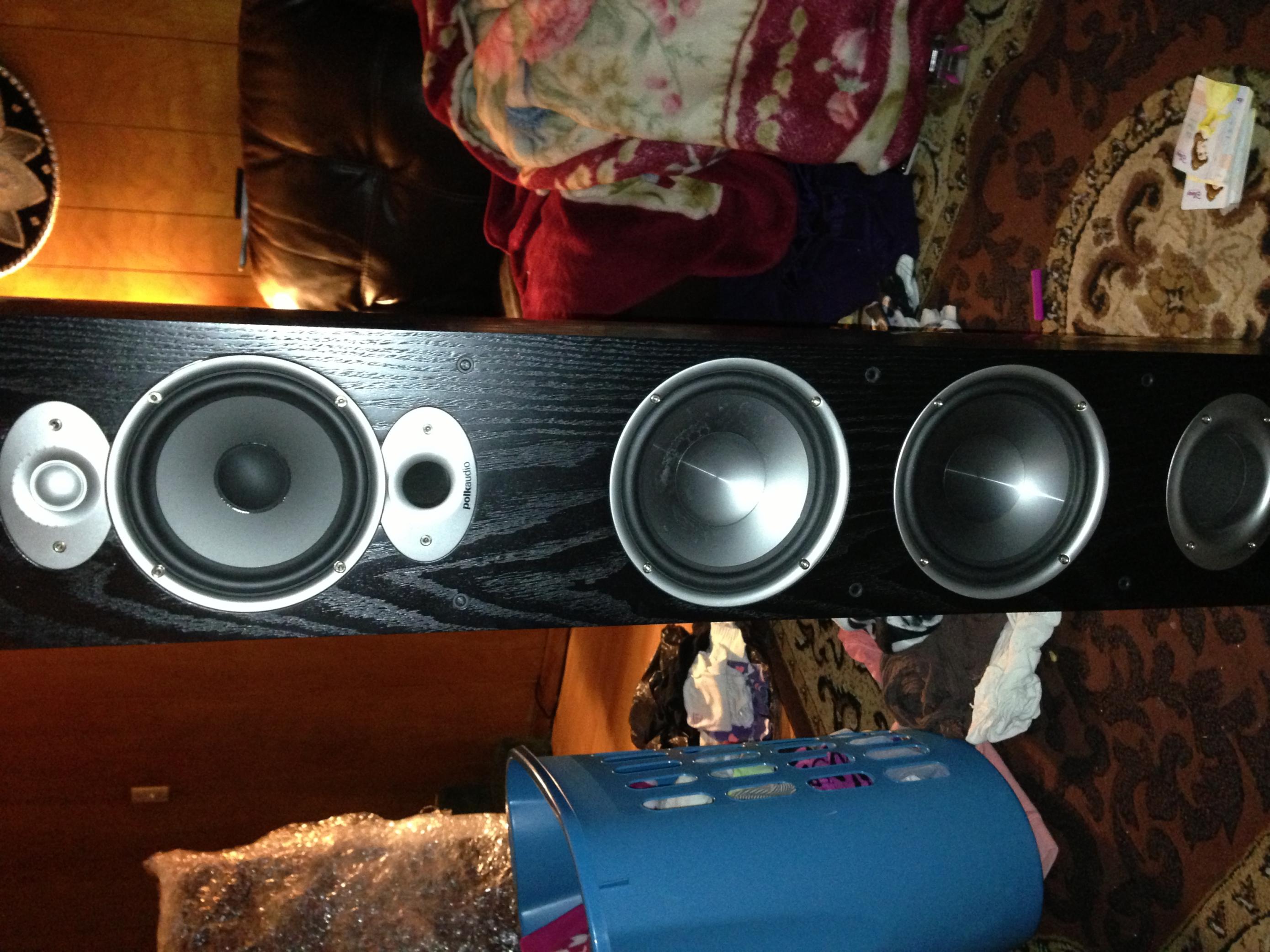

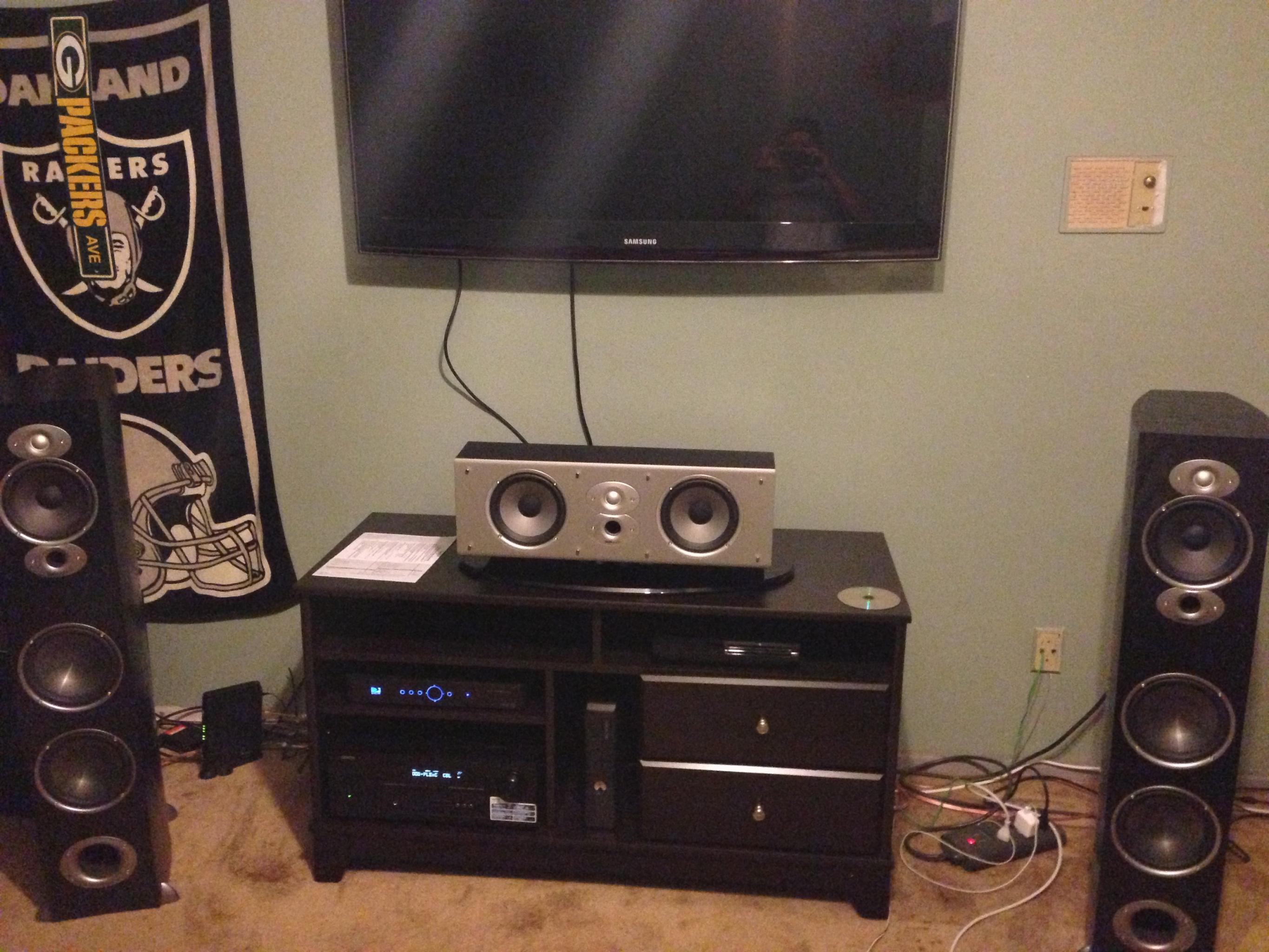

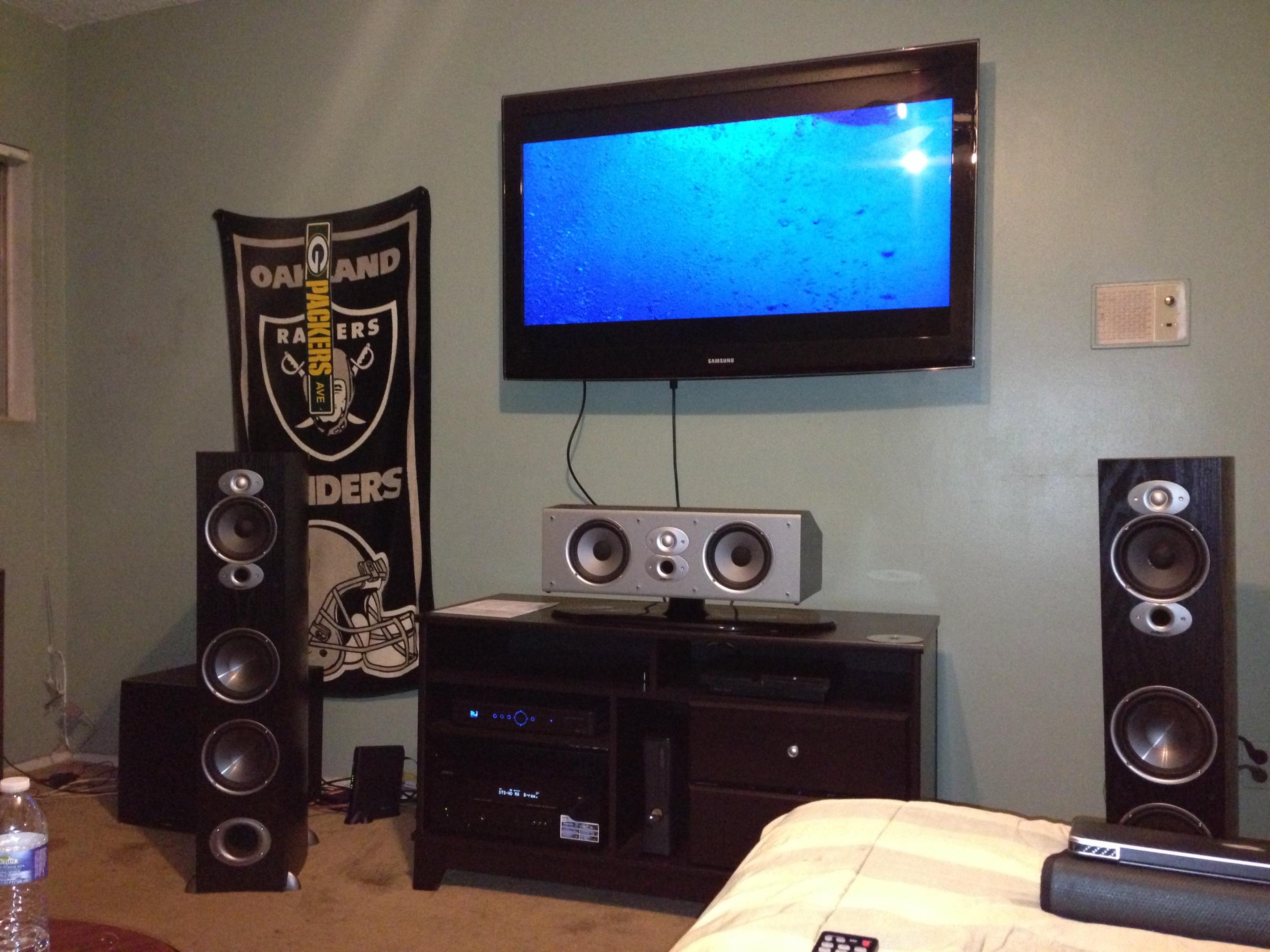

Just picked up a pair today. Went from TSI400 to the A7s and I must say the difference is almost night and day. I wish I could do them justice with a better receiver and amp but for now the Denon AVR-1913 will have to do. I did have some questions though.
1.Audyssey set front and center speakers to full band, is that correct?
2.SHould I set them to small and if so, at what HZ?
3.Surround(TSi400) also to full band but I changed it to small, is that ok?
4.Surround back were set to small @80hz which sound about right.
Thanks for any help in advance.
At some point I plan to upgrade the receiver and Purchase the amp but I'm already dug myself a big whole with the current setup and the budget does not allow for anything at the moment.
I'm fairly new at this so bare with me.
