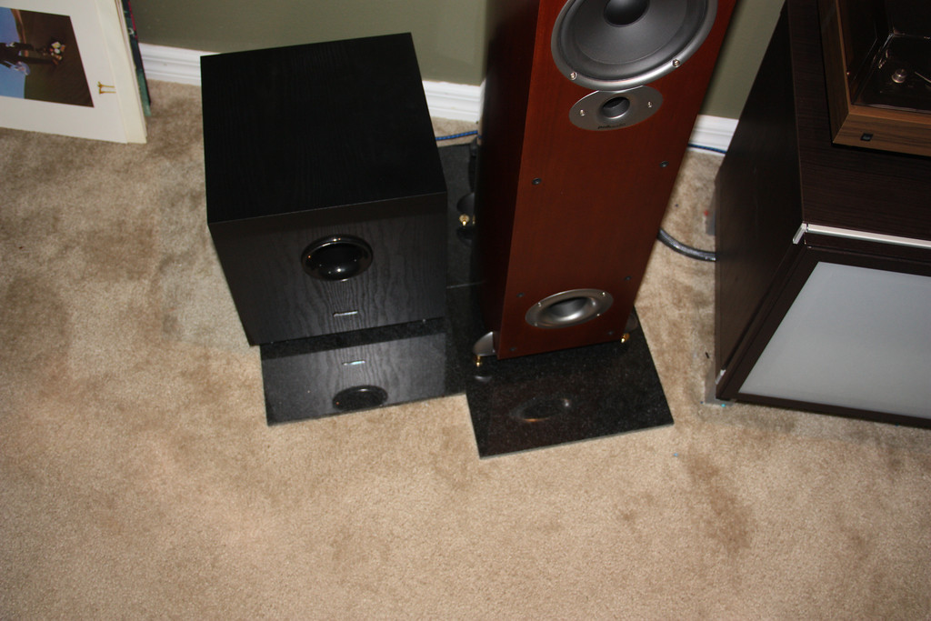

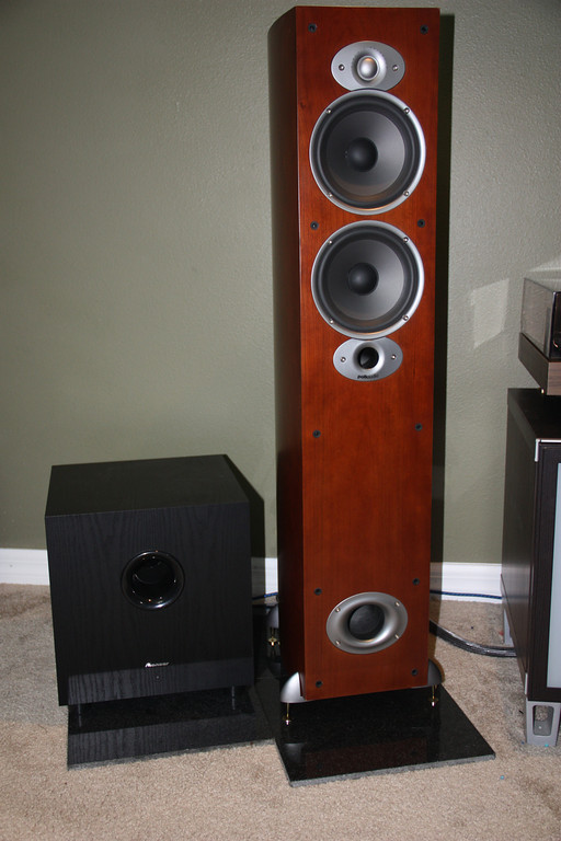

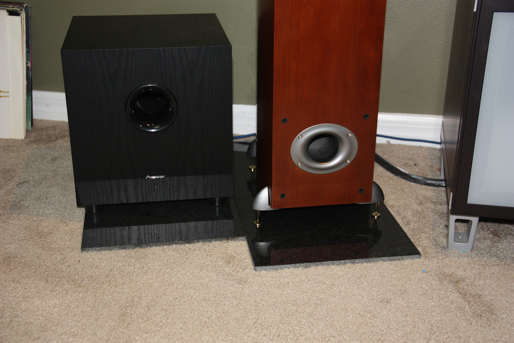

    I got the spikes on. Rethreaded the feet to match the spikes. Everything went flawlessly. I installed spikes on my turntable as well as adding 10lbs of aquarium gravel to give it some weight. I also installed two spikes on the from of the csia6 so it aims the speaker upward toward the seating position.
    I added some black granite tiles to complete the look that I wanted. I have the speaker sub combo mirrored on the right side as well.
    Looks amazing with my accent lights. All the spikes and tile cost less then $100

    specd_out, I hate to tell you this, but by placing your spiked speakers on a slab of granite on top of the carpet you're not getting the benefit of using spikes because the carpet/padding is still de-coupling the speakers from the solid floor. In order for what you've got to work, you'd have to spike the granite as well.

    I dont think that granite is thick enough to spike, but that could look pretty cool, spiked granite on spiked speakers.

    Oh I know. It got a little better then before, but I did it for looks. We are getting wood floors soon so it wont be much of an issue. The gold spikes and the black granite just look so good together, thats all i care about at the moment.
