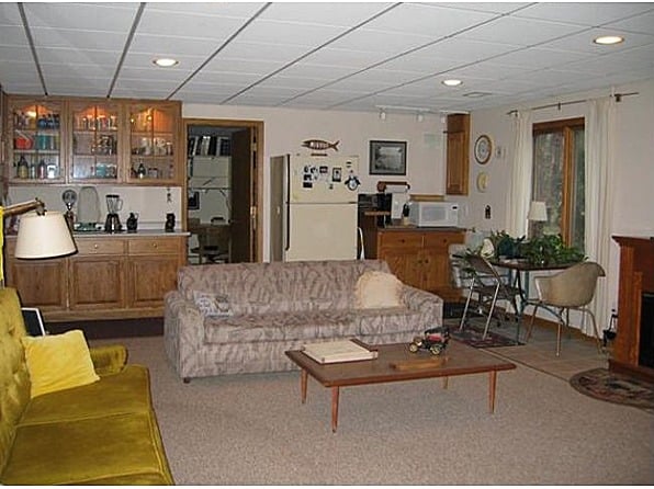

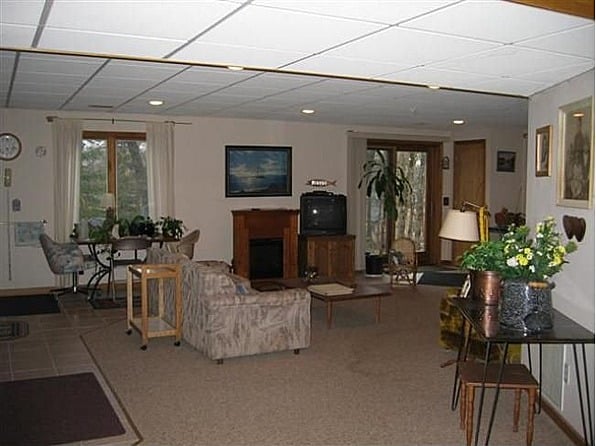

Here are a few actual pics (not very good shots) from the listing when the other folks lived there.
Option orange would be where the fake fireplace, picture and tube tv are in the attached pic 1. The couch in the same pic is facing what would be option blue.

I like the blue configuration simply for the acoustical flow.Marantz AV10-Emotiva ERC3-Denafrips Venus-Panasonic UB9000-AudioQuest Power Quest 707-Emotiva DR3, DR2, XPA2, XPA6-Focal Kanta No2, Sopra Center-PolkAudio RTiA9, RTiA3, LSiM 702F/X-Epik Empire-11.2
+1
Lets see some pictures when your finished!B&W CM9Classé Sigma -
Orange, but move the surrounds closer to listening position.
My vote is for the blue.

Stick with the blue configuration.
Orange, your surrounds are too wide unless you can squeeze them closer?
I'd still stick with the blue as you'll be able to utilize the space better but that's just me. You can't add anymore chairs to orange if you ever want to expand.Where’s the KABOOM?!?! There’s supposed to be an Earth shattering KABOOM!!! -
