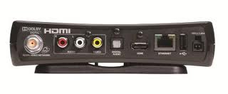

Hello all,
I just got dish network with the hopper. There are three satellite units that do the same thing as the hopper called the joey.
Here is the back of the joey
I have the optical connected to my HK 3490.
The HDMI is connected to the tv.
Here is the issue...Only non/HD channels will submit sound through my stereo with this connection. The HD ones do nothing. I've tried every audio setting possible on the tv, the joey and the HK but can't seem to figure it out.
The picture and sound to the tv are great, but I want to listen to the audio through my stereo.
I know the connection works, because it works on non/HD channels, but I don't watch any non/HD channels.
Anyone have ideas??

    EndersShadow Posts: 17,748
    edited December 2012
    Does your TV have an optical out? If so go HDMI to the TV and optical out from the TV to the HK. That should work for all channels.

    I would check your audio/dig settings on your joey again....there's probably a 2-channel "downmix" setting or something you are missing.

    Yep that's what I was thinking. On DTV you can choose either DD 5.1 or Stereo PCM. Since you are using a 2 channel receiver you may have to use the Stereo PCM setting on the "joey" (isn't that cute!).
    I will also say that ES suggestion should work as well. That is what I do with my bedroom setup since I have a roku that only has hdmi and analog outs, and my older receiver has digital inputs but no HDMI. So I run HDMI from both my DTV dvr and the roku into the tv and digital coax out to the receiver. And that way I only have to change inputs on the TV, not the receiver, and full DD 5.1 is passed through the tv to the receiver.

    There is a pcm setting on the joey.
    But when I toggle between the inputs on the HK the only optical setting I get says "non-pcm"

    something is not right that. I have a Joey and HDMI to TV and Toslink to Receiver and I have sound on all channels

    I think you should be looking for the downmixing setting on the dish box itself and not the HK. The HK likely doesn't have a DTS or DD decoder and doesn't recognize the non-PCM signal. Without a decoder the HK wouldn't be able to down-convert.

    yes get into joey menu to see the PCM menu. I didn't realize that A/V HK is stereo only and on the HD channels it is seeing DD and non HD it is seeing stereo signal.

    Correct he needs to check ALL settings on the dish box. He'll need to down convert to 2-ch stereo/and PCM or LPCM (same/same).

    Nope just the Joey menu. its different than the Hopper. Every Joey has it's own menu that can be configured to each needs.

    I changed every available audio setting on the joey. I'll try again tonight, but I've tried five or six times already.
    Just ordered a 12' belkin optical for $10 bucks of Amazon. Going to run it from the optical out on the tv. Hopefully that works.

    Strange. I wonder if the Joey doesn't send a downmixed signal through the optical connection. How does it behave on your STR-DG1000? Could be a way to test to see if it send a DD or DTS signal through optical when you watch HD content (regardless of the box settings).

    The options the joey gives me are 1) Dolby/PCM or 2) PCM only.
    Then Volume Leveling 1) Enable or 2) Disable
    Then Mode 1) Line or 2) RF
    Any combination of these options still doesn't work.
    Like I said, hopefully, the optical out from the TV works.
    Thanks for the suggestions, all.

    Joey has a menu icon for audio in there are two options Dolby/PCM and PCM only you should try the second
    audio icon is past the first menu in the first menu pick settings then pick audio.
    have you tried the analog output? you know the red/white RCA's? for your reciever that is most likely your only choice.

    Hooked up a pair of Frank's signals tonight. All channels great in audio. We'll see if the optical works through the TV, otherwise at least there is red and white :}
  • hochpt21
    hochpt21 Posts: 5,423
    Optical works through the TV. We're all good.
