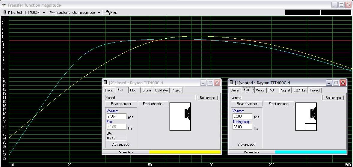

The cabinet design is a simple sealed design. A vented design is easier in most cases because it results in an extended flatter bass response. The problem is that when you drive a signal below the resonant frequency of the driver, excessive excursion is exhibited because there is nothing to restrict the movement of the driver. To compensate, an amplifier can implement a sub-bass filter (which adds to the cost, more so as the filter has to be adjustable for each individual driver). In this case, Dayton uses a sealed cabinet. The sealed cabinet uses the compressed air in the cabinet to restrict the excursion of the driver. Very simple but it has one serious issue. The end result is a reduction of bass as the frequency goes lower. The sub peaks at 80Hz and slowly tapers below that (35Hz@-3db, 22Hz@-10dB, not too bad). Using a vented cabinet would peak at 50Hz and would be -3dB@22Hz but it would have to be over five cubic feet in size.
Frequency response sealed vs vented design
