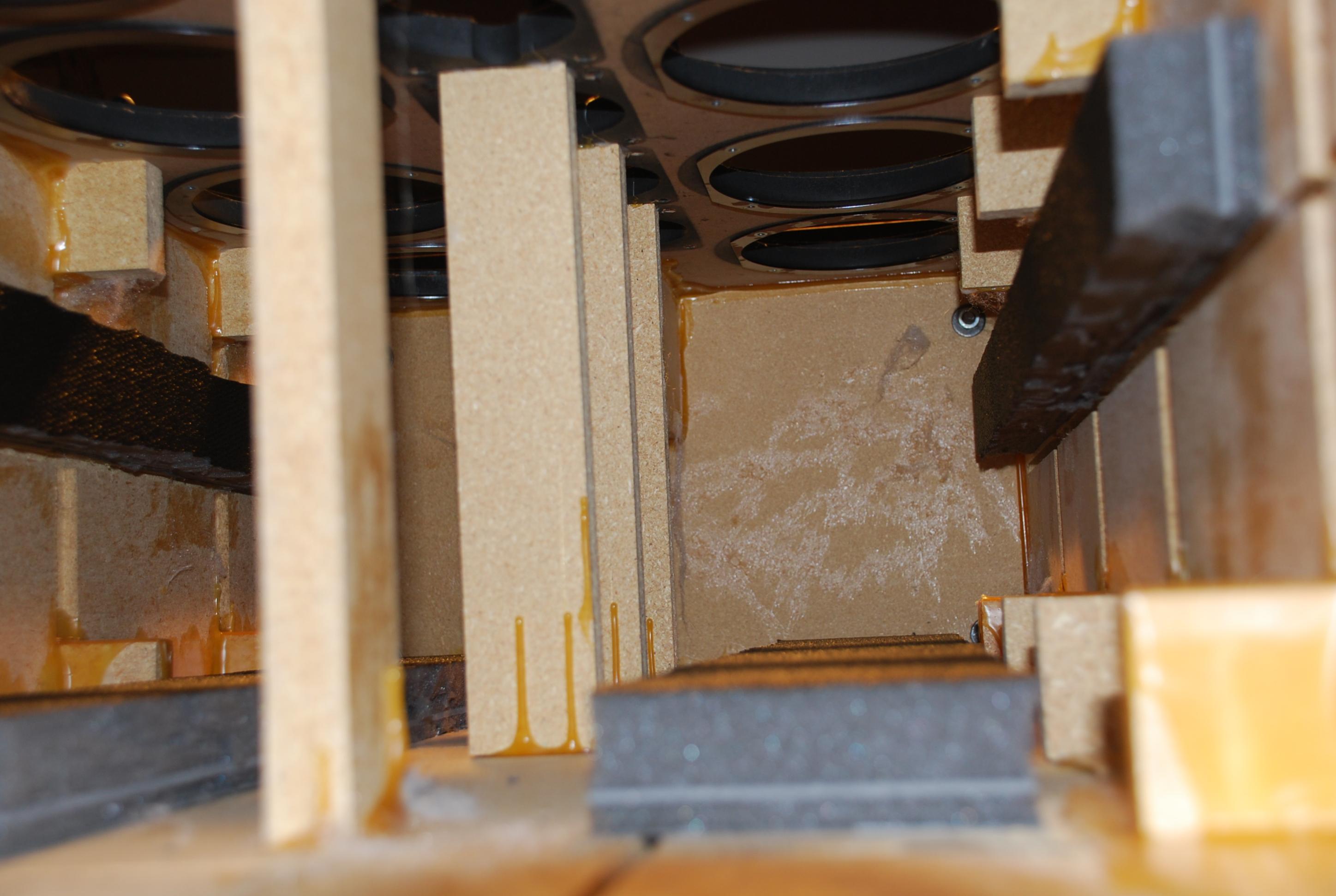

    I used Black Hole 5 behind the mids (one 4" strip behind each) and along the sides (one 2" strip on each side) in my SDA SRS1.2s. I cannot comment on what precisely the effect was, because I implemented several mods at once. Overall clarity and distnctness of midrange was definitely improved.
    Here's a picture:
    I second Toolfan's "Trey for Polkie of the year!"
