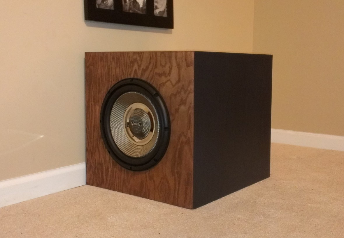

Ok so I couldn't resist a good deal on two of the Kappa 120.9w's (open box for $89/per they had a few more and some other types). I figured for a few bucks more why not:
3 lbs of fill and it is incredibly smooth. I have a pro-audio sound card and was able to use a 3rd channel (out of a total of four outs) and use the built in cross over function in it's mixer to sum L+R and then set the Xover at 100hz with a 24dB / Octave roll off.
It's so seamless that you don't know it's there until you pull the plug on the 3rd channel and then you are going WOW.
Now I know why so many people are building Jinjuku's dual opposed with these Infinity subs. Just an incredible value. I don't even think $1K would get you there commercially. I can always build another but one seems enough. -

I finally got over my fear and really turned up the volume. I had the multi-picture frame knocked sideways. I literally bounced off center. Unbelievable. He did a great design.
