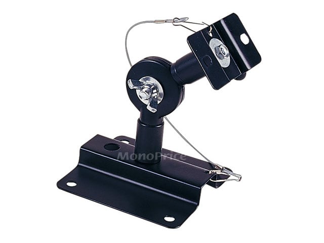

I have already picked up some of these mounts (below). My guess is I can unscrew the keyhole mount and screw into the same location.

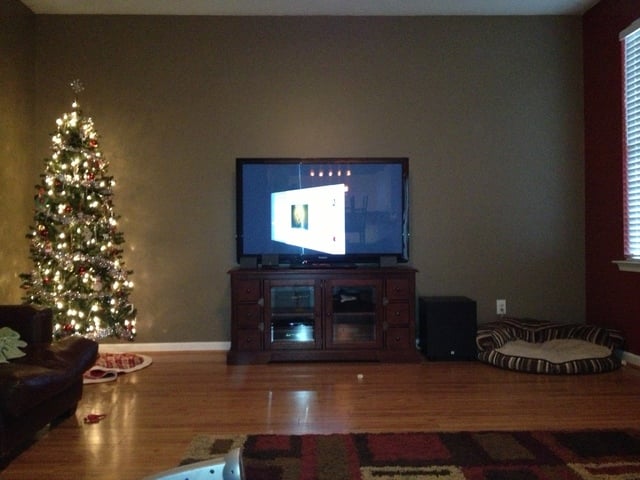

Just a couple more bits of info.
The speakers will be ~ 4 feet laterally from the sides of the sofa and must be located as high in the corner as possible.
Here is a pic from the center of the sofa at seating position. -
I'm in a similar situation with my FXiA6 and RTi4's.
Take into account how much "tilt" you need, and the distance from the wall that the speaker will need to be to obtain that much rotation. For example, even with the mount, the speaker may only tilt 10 degrees or so because of the size of the speaker box. Hold the speaker next to the wall at your desired tilt angle,, and see how far it needs to come off the wall. My guess is its probably a lot more than you think.Polk Fronts: RTi A7's

If you are looking for a good solid mount that tilts and swivels then I recommend the pinpoint am40. They work perfectly for monitor 30s and 40s. I found these on Amazon that look identical to the pinpoints, probably the same thing
http://www.amazon.com/gp/aw/d/B000X9O8SI/ref=redir_mdp_mobile?keywords=pinpoint%20am40&qid=1354247727&ref_=sr_1_3&sr=8-3Pioneer SC-25 | Adcom GFA-555 | KEF q900 Front | KEF q600 Center | Polk Monitor 30 Rear | Polk CS2 Rear Surround | Polk DSWPRO 660wi sub
