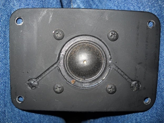

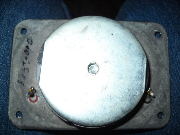

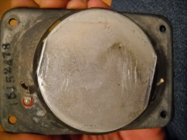

I recently purchased these from my local vintage audio shop. They came out of a pair of beat up 7's (not sure which model as I didn't bother to ask) and I assumed they would fit in my 7C's but alas they do not. I was hoping the knowledgeable here can help me identify them as to what models these are, date of mfg etc.

Here is front & back of 1
Here is front & back of 2
TIA

Not on 7C's as 7C's use SL2000 (silver) or SL2500 (may be, not sure) with different plate dimensions.
Those peerless tweeters are from 7A's like these: http://www.polkaudio.com/forums/attachment.php?attachmentid=76020&d=1349626300.
Drop in replacement for 7C is RDO-194 if they have silver SL-2000 tweeters.
Thanks for reply, I was also hoping to figure out around what year they were mfg, any thoughts on why one of them has an indent on back plate and the other doesn't?Monitor 7C's With Tubes

Those are very early Denmark made Peerless. 1979-1981 keith
