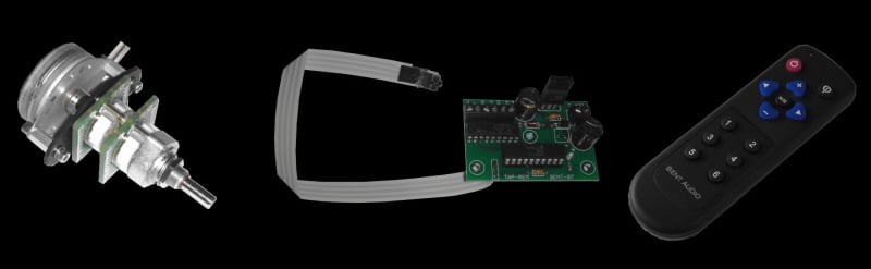

I really like the idea of building my own preamp (most likely tube), but having remote control for the volume is a must for me. The Grounded Grid kit is well priced, and has nothing but high praise, but no remote control; same with about everything else. I emailed Bruce to ask him for any suggestions, but he just said it depended on what was available. There are plenty of cheap remote control volume kits on ebay, but if I were to build the Grounded Grid or something similar, having a cheap pot in the circuit really defeats the purpose. Has anyone used one of the kits from Bent Audio? Kits from anywhere else? Bent has a really nice looking remote control kit for a GoldPoint stepped attenuator for $200; not including the attenuator. Pricey, but a remote control GoldPoint inside a Grounded Grid seems like a killer combo.
Tell me what you've used and how well did it work; thanks!

    If you like the ALPS pot, a remoted controlled version from Bent Audio is a great option. The remote control GoldPoint is still one of these best options in my mind, and the fact that you can buy the attenuator and the motor separately help with the high price tag. I'm currently eyeing the Khozmo attenuator which also has a remote controlled option. So far I've found that there is no cheap option for good attenuation that is remote controlled.

    There are many remote control kits and some other nice looking ones, but not all of them can be controlled without the remote as well, which removed those as options for me.
    The remote ALPS is very good as I've had them in all my favorite gear, but my current speakers are especially sensitive, and aren't working well with my manual ALPS, so I know the remote controlled isn't an option for this application.

    A circuit for the remote control system will have to be added for any remote kit you add. Sometimes you can find an appropriate voltage in the preamp, and sometimes you have to add an additional power supply.
