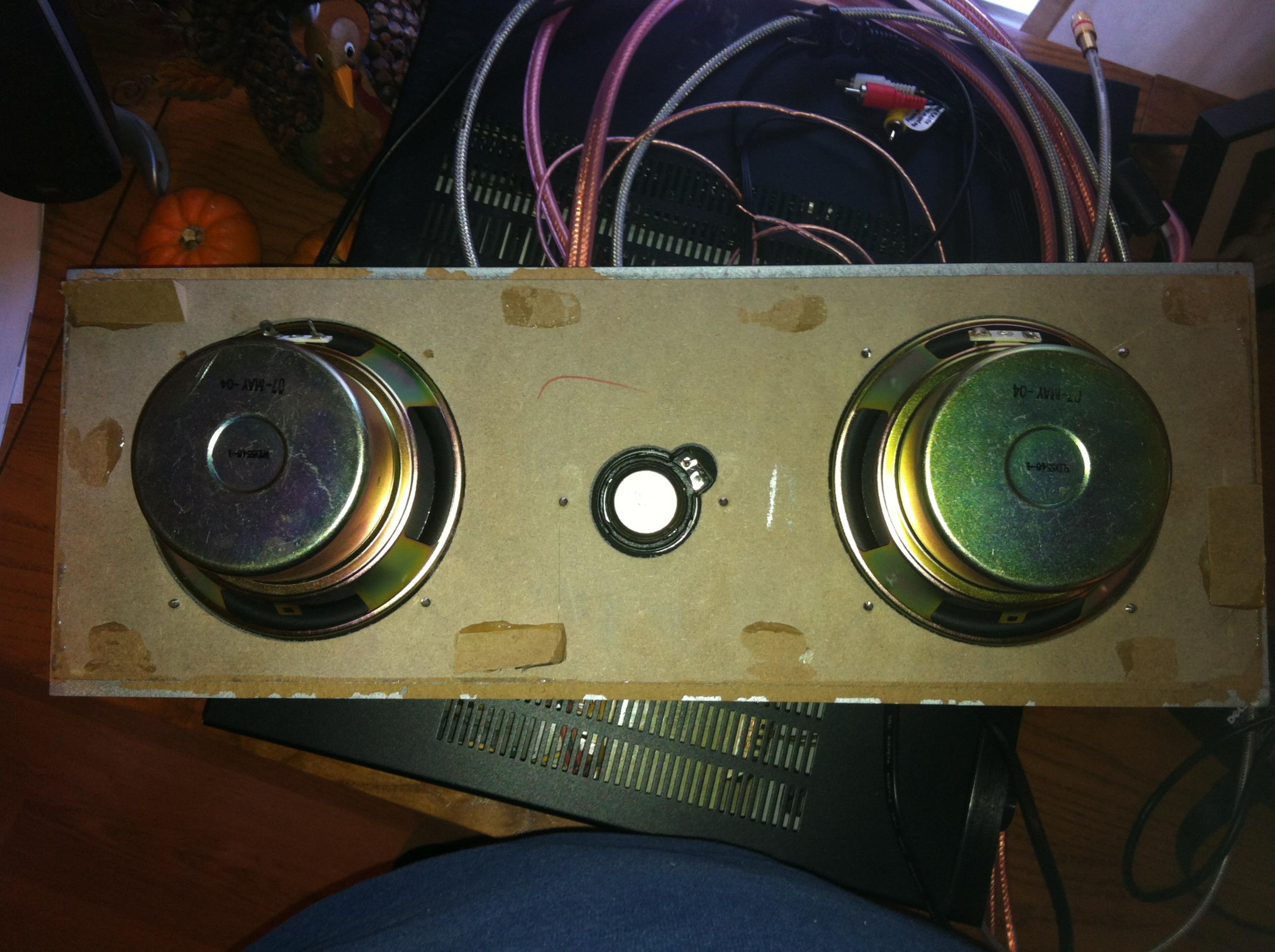

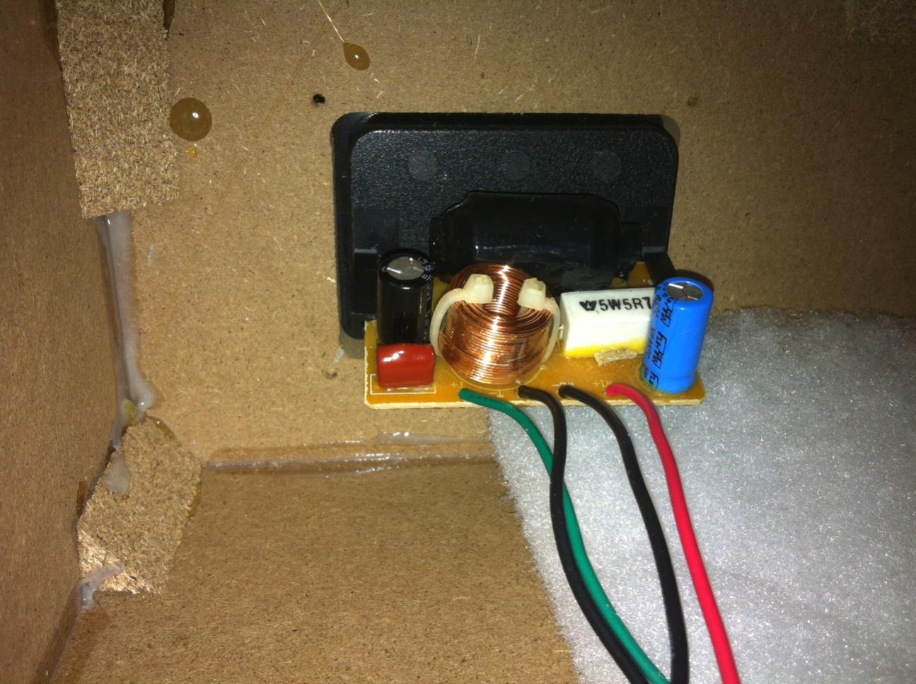

I am a noob and an amateur in all sense of the word. I have had my CS2 for like 7 years now and have loved it! Well I dropped it last night, the housing came apart and unplugged all the wires inside. Everything is in good shape, except the cabinet, which I am sure I can glue back together. What I need is a wiring schematic of some sort to plug the wires back to the speaker parts themselves. Any help would be appreciated. I've attached a couple pix.

    Look on the crossover...
    T+ is tweeter +, T- to Tweeter minus, the other plugs go to the woofers + and -, and the "link cables" between the woofers go + to + and - to -

    Worked perfectly! Thanks do much!
